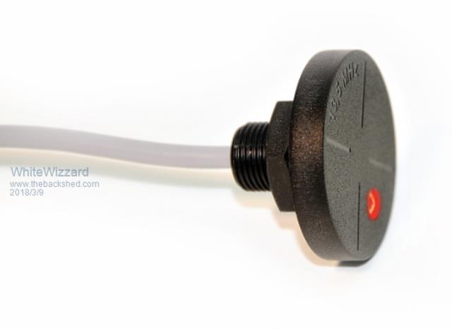

I will post a picture of the reader in a little while!
Posted: 10:40am 09 Mar 2018
The One-Wire RFID reader as mentioned in my previous post. I have not added these to the website ye; however, I do have both 125KHz and 13.56MHz versions immediately available.
Will post a code snippet next to show ease of use

Posted: 10:51pm 09 Mar 2018
Forgot to mention that the reader pictured above has a diameter of approx 35mm; and a max read range of 4cm
And low cost 13.56MHz NFC 'stickers' can be used on other 'bait' items - however, only one tag can be read at a time.
