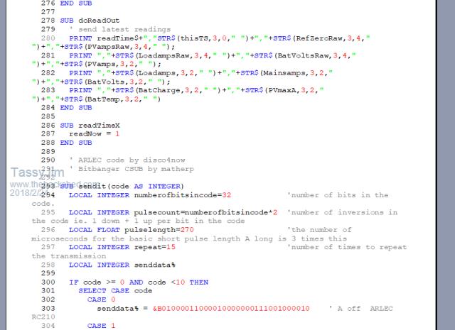

Posted: 01:51am 24 Feb 2018
If it starts with a digit, &H (hex), &B (binary) or &O (octal), it's a number
27BDFFC0
&HAFB1001C
&B01000011000010000000010001001111
&OA6410015
AFB1001C
anything else is a 'word'
It does cause a few issues with CFUNCTIONs
I will add the option to print line numbers to RTF, but you will have to live with any consequences. My main objection is, you loose the ability to copy and paste back into MMEdit because of the pesky line numbers.
