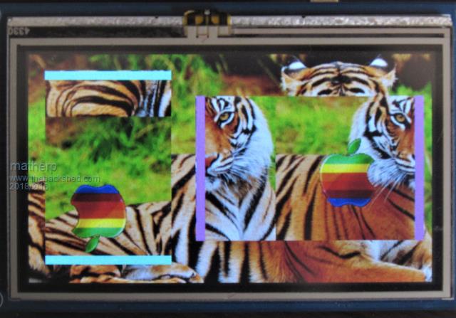

This release optionally uses some of that available RAM as a framebuffer for various displays in order to overcome some of the limitations of directly addressing the TFT display. This is best explained by watching a video of sprites running on a 4.3" SSD1963 display using a driver with and without the framebuffer.
The mechanism of moving a sprite is as follows:
1. replace the sprite with the stored background
2. scroll the background
3. save the background for the new position of the sprite
4. re-display the sprite
The effect of this can clearly be seen in the first part of the video where the sprite flashes repeatedly and is only barely visible between loops of the program.
By using a framebuffer, all of these steps can take place within the memory of the Micromite and only when they are completed the complete area affected is written to the screen as a single operation.
