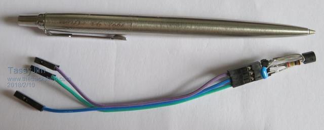

My test setup had flying leads about 100mm long.
20mm should be OK
