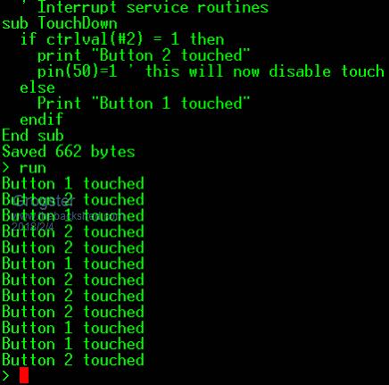

Works OK for me.
No errors, no lockups, touch continues to work fine.

E64 module(same chip as you), 5.04.08
I have one permanently setup here with a 7" LCD on it for development, which is why I could test your code immediately.
