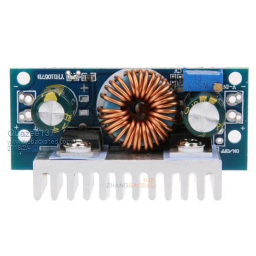

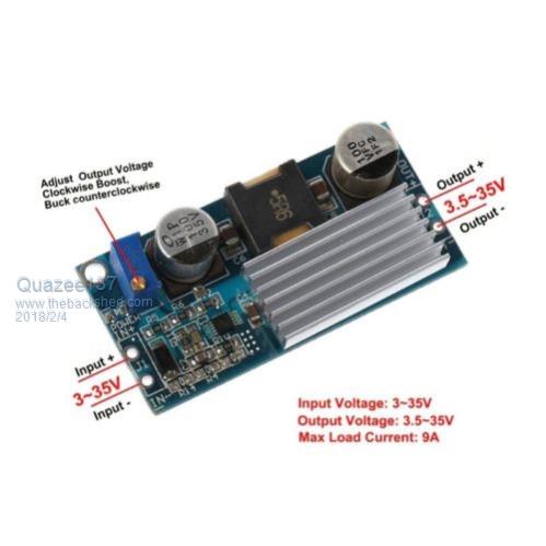

You can see if these will do.
150W DC-DC Boost Converter 10-32V to 12-35V 6A Step Up
Seen them when looking around ebay for a 3.3V to 9v or adj module.

Posted: 01:25pm 05 Feb 2018
Hi Rob and Quazee137. i like the idea of the buck converter so i will be looking at that further. As a temp measure I have used some diodes to reduce the voltage a bit. the light hasn't diminished much but certainly the heat has dropped. The COB lights i think were not intended for automotive use hence the issue.

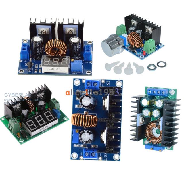

Posted: 07:21am 06 Feb 2018
hello all, I think you need a step down converter, for example if you use the first boost converter of the image from Quazee137 has these features 150W DC-DC Boost Converter 10-32V to 12-35V and you feed it with 14.5 volts your output will be 14.5 to 35v instead if you use a Step Down Buck Converter 7-40V To 1.2-35V and you feed it with 14.5 your output will be approximately 14 down to 1.2v and this model has a nice voltmeter.

Posted: 08:33am 06 Feb 2018
the problem with using a single step-up/down converter is that when all the lights are off the converter is still drawing power. depending on your setup, this 'idle' current may be a problem.
one other option may be to have a 24v distribution system, with small 12v step-down converters at each light fitting.
