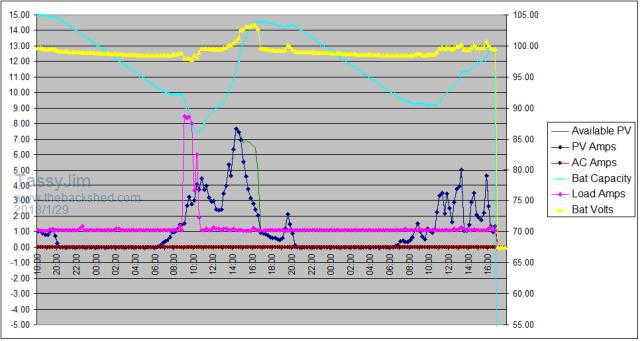

Posted: 06:40am 29 Jan 2018
It depends on how much time you want to spend looking at the data.
I usually start with dropping the data into a spreadsheet and experiment with charts there.
New data gets pasted over the old and the charts don't have to be re-invented each day.
Once I am happy, I will write a Windows program to retrieve and chart the data.
Often, I never get past the spreadsheet stage.
This is the output from a solar powered radio repeater I look after. The readings are done my a micromite and it keeps the last 2 days so I can retrieve at my leisure.
(very cloudy the last 2 days)

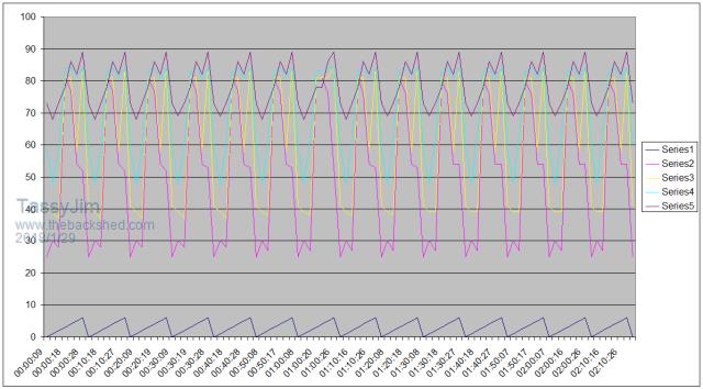

Posted: 07:27am 29 Jan 2018
Once the spreadsheet is setup, you just copy the next days data and paste it in.
I did a quick and nasty based on your data and found that the cyclic nature of the data produces poor charts for a full day.
This is the first 100 points
And this is the spreadsheet that did it. I left the chart at 100 points for now.
Try pasting another day over the first column. Provided your data stays at fixed length, it should work out OK

Posted: 07:33am 29 Jan 2018
Jim, Your spreadsheet graphing is similar to what I end up with but I am not sure how to improve it from there. The probe numbers 0-6 end up in the graph rather than being different pages. The time and level axis are ok.
OA47
Could I save the data in a different format to improve the graphing?Edited by OA47 2018-01-30
