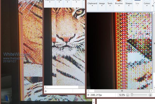

With your 'scrolling tiger' code I am seeing three things:
1> When scrolling down, there is 'garbage' appearing (from the top as it scrolls down) on the left hand edge of the screen (approx 12pixels wide)
2> when scrolling right, the whole left hand 12? pixels seems to be one or two pixels lower than it should be. The 'garbage' from above point suddenly displays the correct image data (but just a bit low)
3> When scrolling up, you then get 12? pixels of garbage appearing from the bottom
NOTE: Then when scrolling left, everything seems 100% correct
The above repeats every time even after a reset / power-down
WW
Posted: 12:15am 27 Jan 2018
Better seen with screen-shots!
Left Image = Scrolling up (similar thing occurs when scrolling down - but 'garbage' appears from the top)
Middle Image = Scrolling Right. I now see from this photo that there is 'Repeat' in the left column of pixels
Right - Close Up of Pixels in left column (for scrolling Up) - Looks like 10 Pixels wide (same width for Up/Down/Right)
Hope this helps debug . . .
WWEdited by WhiteWizzard 2018-01-28

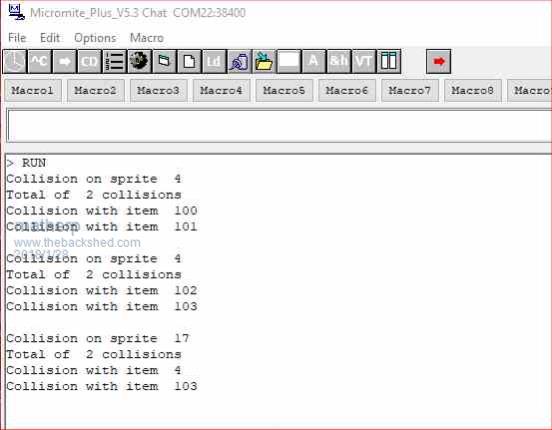

This starts to implement collisons. This is best explained by a very simple commented example
Option explicit
option default NONE
load image "tiger640"
sprite INTERRUPT collision ' specify the interrupt routine to handle collisions
sprite load #4, "apple"
sprite load #17, "apple"
sprite show 4,-10,-10 'show a sprite overlapping the top and left of the screen
pause 1000
sprite show 4,600,440 'move the sprite to overlap the bottom and right of the screen
pause 1000
sprite show 17,550,400 'show a sprite overlapping the previous sprite and the bottom of the screen
do
loop
end
sub collision
' collison with the left of the screen returns code 100
' collision with the top of the screen returns code 101
' collision with the right of the screen returns code 102
' collision with the bottom of the screen returns code 103
local integer i
print "Collision on sprite ",sprite(S) 'sprite(S) returns the sprite that moved to cause the collision
print "Total of ",sprite(C,sprite(S))," collisions" 'sprite(C, #n) returns the number of current collisions
for i=1 to sprite(C,sprite(S))
print "Collision with item ",sprite(C,sprite(S),i) 'sprite(C, #n, #m) returns details of the mth collision
next i
print ""
end sub
This gives the result:
Yet to be implmented is collisions caused by moving the background (layer 0) and any sprites on that layer. Collision detection is currently based on the rectangular outline of the two sprites. Only sprites on the same layer collide.
My intention is that sprites on layer 0 will collide wiith all other layers - comments?

local integer i
print "Test : ",testrun
testrun = testrun +1
if sprite(S) <> 0 then 'collision of individual sprite
process_collision(sprite(S))
print ""
else 'collision of one or more sprites caused by background scroll
print "Scroll caused a total of ",sprite(C,0)," sprites to have collisions"
for i=1 to sprite(C,0)
print "Sprite ",sprite(C,0,i)
process_collision(sprite(C,0,i))
next i
print ""
endif
end sub
sub process_collision(S as integer)
local integer i ,j
print "Total of ",sprite(C,S)," collisions" 'sprite(C, #n) returns the number of current collisions
for i=1 to sprite(C,S)
j=sprite(C,S,i)
if j=100 then
print "collision with left of screen"
else if j=101 then
print "collision with top of screen"
else if j=102 then
print "collision with right of screen"
else if j=103 then
print "collision with bottom of screen"
else
print "Collision with sprite ",sprite(C,S,i) 'sprite(C, #n, #m) returns details of the mth collision
endif
next i
end sub
Results are
  Quote  RUN
Test : 1
Collision on sprite 17
Total of 2 collisions
Collision with sprite 2
Collision with sprite 4
Test : 2
Collision on sprite 4
Test : 3
Collision on sprite 2
Total of 1 collisions
Test : 4
Test : 5
Collision with sprite 17
Test : 6
Scroll caused a total of 1 sprites to have collisions
Sprite 17
Test : 7
Scroll caused a total of 2 sprites to have collisions
Sprite 2
Sprite 4
