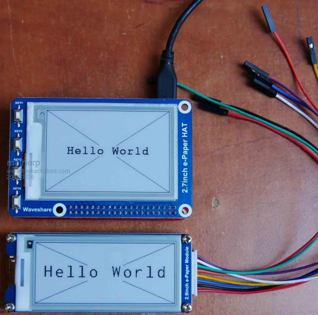

Attached are display drivers for the 2.7" and 2.9" E-ink displays.
These are written entirely in Basic using the new "User" driver capability in the latest release of the MM2, MM+ and MMX firmware.
The displays are S.....L.....O.....W
A screen refresh on the 2.9" display takes just less than 3 seconds and somewhat over 5 seconds on the 2.7" display (note this is not significantly affected by the Basic code - re-writing in C wouldn't help). Also the displays flash from a normal image to an inverted one and back to a normal one as they refresh.
but they are Very low power
As seen in the picture the 2.9" display is drawing 0 amps as it isn't connected.
When in circuit is draws about 0.7mA. I haven't measured the 2.7" display but I assume it is similar. The 2.7" display also has 4 switch inputs, useful for controlling an application.
The 2.7" display is mounted on one of my MM+ HAT stands (the red one). and the pinout in the code suits this layout but can be altered for any other layout. NB for the MM2 you also need to change SPI2 to SPI in the code (4 places)
Despite the adverts the displays are orientated in portrait mode:
176 x 264 for the 2.7" display
128 x 296 for the 2.9" display
I'm using the Rotated Text facility on the MM+ to print the text in Landscape (MM+ manual - page 27).
There a number of other E-ink displays available in various sizes and it should be easy to modify the code to suit (just look at the supplied Arduino "init" routine for the likely differences)

@ matherp
I have ordered one of the 2.9" displays for a project, I am trying to work out the
connections. In your code is 'const CE0 = 62' the CS pin.
Paul.
edit. Silly question, why CE0 and not just CEEdited by palcal 2018-02-02

@ Matherp
I'm trying to drive a 2.13 in display (3 colours) with your 2.7in driver above. My unit has 104 x 212 pixels.
It appears to initialise, but stops at the drawline command , with "display not configured"
The option lcdpanel user, 104, 212 command says error, arguments.
Is there any info about the option user command available?
I would love to get this panel going because they have the priceless virtue of being readable using sunglasses!
TIA Dave.

@ Matherp
Finally got a chance to try my 2.9" E-Ink display using an E-28 Micromite. I get an error....
  Quote  [53] Dim S$(MM.VRes-1) length MM.HRes\8
Error: Dimensions
I tried using 'Option LCD USER, 128, 296' at the command prompt but get an error
'Argument Count'.

Edit:
I used the following pins.
CLK = 25
DIN = 3
CS = 2
DC = 17
RST = 18
BUSY= 9
I changed the Constants to these pin nos. and changed the 4 instances of SPI2 to SPI.

Ok I have now loaded the file into an E-64 but now get an error...
  Quote  [297] i=SPI2(databyte)
Error: Not open
Paul.
Edit..
Thinking there maybe a problem with SPI2 I changed to SPI1 and it works OK.
I loaded it into the library, now how do I use it, do I have to delete the lines
  Quote  userdisplayinit(0)
line 0,0,mm.hres-1,mm.vres-1
line mm.hres-1,0,0,mm.vres-1
box 0,0,mm.hres,mm.vres
text mm.hres/2,mm.vres/2,"Hello World",CMU,5
refresh
end
Edited by palcal 2018-03-12
Posts: 12085
Posted: 08:27am 11 Mar 2018
  Quote  I loaded it into the library, now how do I use it, do I have to delete the lines
You need the line
userdisplayinit(0)
at the top of your program as this initialises the display.
Then just use exactly like any other display except that you need to call "refresh" when you want the display to be actually updated.

I have it working OK but it is much slower than you stated. Using this small piece of code,
timer=0
userdisplayinit(0)
text mm.hres/2,mm.vres/2,"Thanks Peter",CMU,5
refresh
print timer
It takes 18 seconds to display but the timer is only reading 2655 ?
Paul.
Edit.... Does the timer stop while the library code is executing?Edited by palcal 2018-03-13

Peter
Will this work with a Picromite?
I've tried it by changing the pin numbers to the correct ones I'm using but it's coming up with this error
[code]Refresh
Error: Invalid command for display type USER[/code]
Posted: 06:54am 31 Jan 2019
@palcal,
Does your timer result (2655) display on your computer screen about 2.6 seconds after running your program AND then another 15 odd seconds more before the e-ink display shows?
If so, then is it not just a hardware 'thing'. I'm thinking that it could be that some e-inks take an age to actually 'show' the result (long after the code is finished).
Hope you follow my thoughts . . .

Posted: 08:37am 31 Jan 2019
Fair go WW that was 10 months ago, I am flat out remembering what happened yesterday.
Anyhow I dumped the E-Ink, too slow.
I might resurrect it for a battery project with the ArmMite L4 one day, but it needs to be something that doesn't need updating very often.

  Quote  I've tried it by changing the pin numbers to the correct ones I'm using but it's coming up with this error
REFRESH is a valid Pi-cromite command for use with buffered display drivers. Just change the name of the subroutine to nyREFRESH or something else
lew247
Joined: 23/12/2015
Posts: 1709
Posted: 09:11pm 31 Jan 2019
I've now got the program running but it's not displaying anything
I have a feeling I've made an error on the board but not sure
Does pin 3,DIN of the E-Ink display go to pin 21 or 19 on the Pi Zero W?
