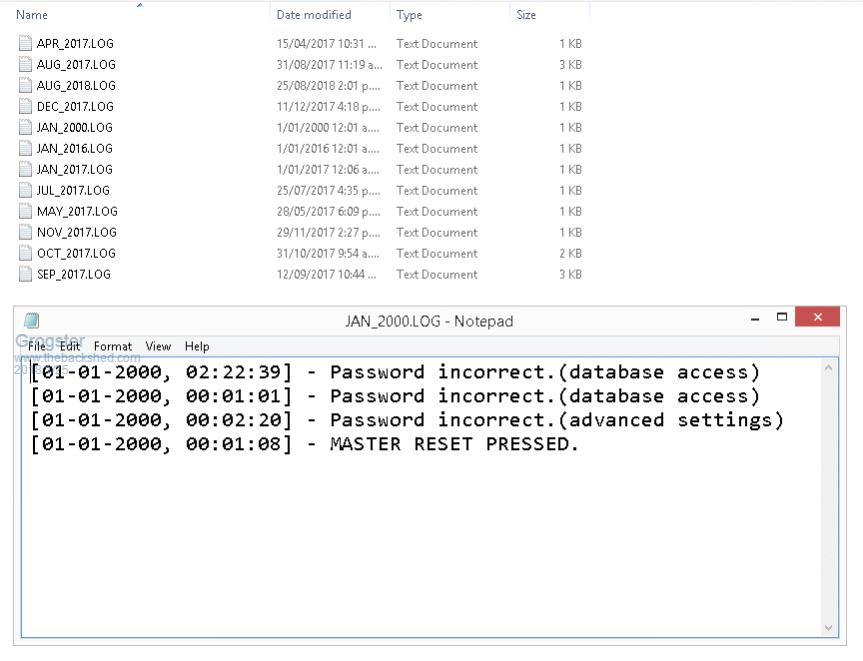

Posts: 10076
Posted: 11:34pm 24 Jan 2018
Hi Phill.
This is what I use in one of my programs, to log any events to a DAILY log file, that changes automatically to a new filename each day.
The ACTLOG(ActivityLog) if/then, is part of the main message processing loop, and ACTLOG is a flag set in the options page so you can turn logging off an on just by checking this flag as part of the normal run through the main loop.
  Quote   IF ACTLOG THEN 'Log this message to today's logfile
T2$=Right$(DATE$,2)
T1$=
Left$(DATE$,2)
MONTH=
VAL(MID$(DATE$,4,2))
LOGFILE$=T1$+MTH$(MONTH)+T2$+
".LOG"
IF DEBUG THEN Print "Append to log: "+LOGFILE$
Chdir "\LOG"
Do While FILE_OPEN_FLAG:Loop
FILE_OPEN_FLAG=
1
Open LOGFILE$ for Append as #4
Print #4,L$
Close #4
FILE_OPEN_FLAG=
0
ENDIF
The beauty of OPEN FOR APPEND, is that if the file exists, it will be appended to. If it does NOT exist, MMBASIC will create it, and start writing to it which makes it nice and simple.
I also have two other subs which are called whenever something unexpected happens(ERRLOG - ErrorsLog), or whenever the user changes anything(SYSLOG - SystemLog). These are MONTHLY logs rather then daily ones, as they don't(or shouldn't!) see as much activity as the daily ones do. T1$ is the data(or message in this case) that you want added to the log, and this is passed to the sub as part of the call to the sub in the normal fashion, then the sub takes total care of logging that message to the current file etc, etc, etc.
  Quote  SUB WRITE_ERRLOG(T1$)
Local TXT$,MREF$,FILE$
Chdir "\ERRLOG"
FILE_OPEN_FLAG=
1
MREF$=MTH$(
VAL(MID$(DATE$,4,2)))+"_"+MID$(DATE$,7) 'Build a reference for current month
FILE$=MREF$+".LOG"
Open FILE$ for Append as #4
TXT$=
"["+DATE$+", "+time$+"> - "+T1$
Print #4,TXT$
IF DEBUG THEN Print FILE$+" - "+TXT$
Close #4
FILE_OPEN_FLAG=
0
END SUB
SUB WRITE_SYSLOG(T1$)
Chdir "\SYSLOG"
FILE_OPEN_FLAG=
1
MREF$=MTH$(
FILE$=MREF$+".LOG"
TXT$=
Print #4,TXT$
Close #4
FILE_OPEN_FLAG=
0
END SUB
I hope those code-snippets help.
EDIT: I should mention that MTH$ is a simple array consisting of:
  Quote   Dim MTH$(12) LENGTH 3
...and the array is pre-loaded with these details:
  Quote   MTH$(1)="JAN":MTH$(2)="FEB":MTH$(3)="MAR":MTH$(4)="APR":MTH$(5)="MAY"
MTH$(
6)="JUN":MTH$(7)="JUL":MTH$(8)="AUG":MTH$(9)="SEP":MTH$(10)="OCT"
MTH$(
11)="NOV":MTH$(12)="DEC"
EDIT: This is the kind of output files the above two routines produce:
The daily logs are pretty much the same format, but the filename is something like 27JUN17.LOG kind of thing.Edited by Grogster 2018-01-26
