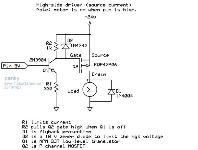

This circuit might be the workaround - a few more components but would let you use the MOSFET above.

Using the above circuit, after deleting the zener, Vgs will be very close to (Vb-.6)* R2/R1
For example if you want 10v gate to source and you have 3.3v input, then R2/R1 will be 10/(3.3-0.6)=3.7 .This would be satisfied by R2=1k2 and R1=330R.
This relationship is mostly independent of the supply voltage.
I wouldn't use this for high speed pwm, but it would be fine for 1kHz or less.
If it is keeping you awake at night, add the zener anyway.

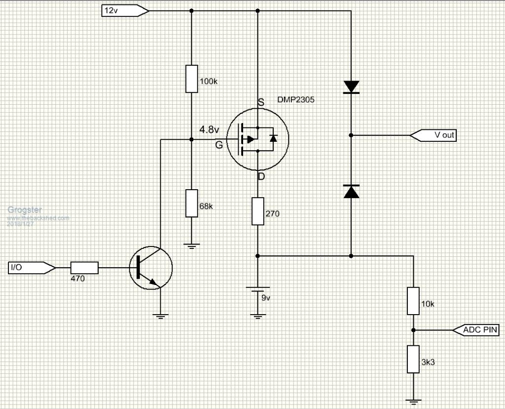

Just to clarify for folks here, the example diagram that panky posted is NOT what I am doing. I am trying to find a MOSFET to act as a high-side switch(with helper transistor) for the battery charging switch thing I discussed in another thread. This is where I want to be able to turn OFF the battery charging under MM control, once a certain time or battery voltage has been achieved, to prevent overcharging. Although, with a trickle-charging arrangement, I might just be making things overly complex for myself for no good reason....
That's the idea, anyway. HAS to be SOT-23, as I have very little PCB real-estate to shoe-horn the extra parts into. Anything bigger - even TO-92 - will be too big.
Switching is simply 100% on or off via an I/O pin. No PWM. ON for up to 24 hours, then OFF till the plug-pack-charger is removed.
I am interested in the zener idea. I have a ton of DMP2305 MOSFET's, but they have a maximum Vgs of 8v. Vgs(th) of 0.9v max. Vdss of 20v. Id of 4.2A MAX. These are my current favourite for all 3v3 and 5v circuits, but I was thinking they were totally out cos of the 8v Vgs, when I want to put 12v on the gate. With the zener idea, I am now thinking I could use a zener on this MOSFET(5v or 6v or so) and then use THAT one - along the lines of what panky and robert.rozee suggest.
Thoughts?

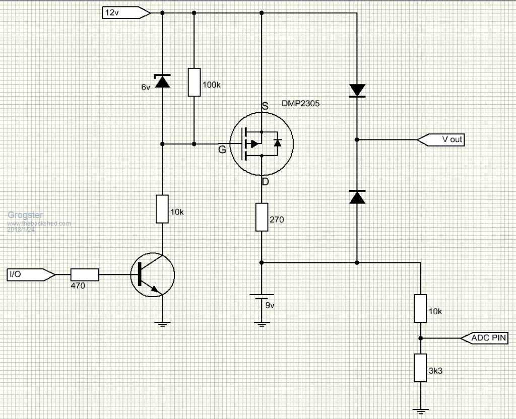

@ Rob: Is this the kind of idea you are talking about....
Posted: 11:38pm 23 Jan 2018
grogster: that is exactly what i'm talking about.
looking at panky's circuit, i think it may also work. Q1/R1 form a constant-current sink, drawing (3.3-0.6)/330 = 8mA when 3.3v is applied to the base of Q1. when the base of Q1 is low (less than 0.6v), no current flows.
the only disadvantage of this arrangement is that IF the base of Q1 is held high while there is no collector load for Q1 (ie, R2 and D2 missing), then the 8mA gets drawn from the micromite's control pin and flows down through Q1's BE junction.
R1 and R2 could probably be scaled up by a factor of 10 (ie, R1=3k3, R2=10k) to reduce the current to 800uA.
note that below a few milliamps, zeners may not regulate particularly well, but in these sorts of applications that doesn't really matter.
rob :-)
Posts: 10076
Posted: 11:48pm 23 Jan 2018
Awesome. Thanks a bunch. That means I can use one of the 2305's I have here, as I have several hundred of them in SOT-23. I'm not entirely sure why I did not think of using a zener on the gate myself, but my little grey cells sometimes......

How about you increase the zener to 8V2 (or as much as 11V) then you can get rid of the transistor and it's 470R, connect the bottom end of the 10K direct to a 5V tolerant pin set to OC. Rob is spot-on with his warning bout Iz - you might want to drop that 10K to 3K9 or even 3K3 just to make sure the zener does its job properly.
chopped two components from your estate!
Ignore this if your 12V is "nominal" - unregulated walwarts have a tendency to be very "about" (read as 17V off load - that would nuke the PIC pretty quickly)Edited by CaptainBoing 2018-01-25
Posts: 10076
Posted: 11:11am 24 Jan 2018
2305's maximum Vgss is 8v. Would not an 11v zener kill it? Where are you getting your 11v reference point with respect to the 2305 MOSFET? Just curious.
Posted: 01:08pm 24 Jan 2018
If the breakdown of the Zener is 11V anything over that "bleeds" backwards through the zener - in this case a single volt. This is enough to turn the FET on (although a bit close to 0.9V). That 1V at a mA or two is easy sucked away through the OC pin on the uC.
With the pin "hi", there is no path to ground so both sides of the zener (and the gate of the FET) are pulled to the supply - Vgs is now zero and the FET is off, take the pin low, source is still 12V, gate is now 1V (Vgs is -1V) and the FET turns on.
Am I missing something? Worried now. hate hi-side stuff it is all backwards
EDIT: eeek "-1v" should be -11V - you are right the FET is dead at this point - ignore me! unless you have a 12v tolerant pin on your PIC you will need that trannyEdited by CaptainBoing 2018-01-25

I kike panky's current sink circuit with some changes:
1. Use a 3.3V pin.
2. Change R1 to 680 ohm.
3. Ditch the zener as its not required.
The current through the 680 is:
(3.3V - .6V) / 680 = about 4mA
4mA * 1K = about 4V guaranteed to fully turn on the MOSFET.
and
The 1K gate resistor will turn off the MOSFET fairly rapidly.
BTW, bipolar transistors are perfect for current sinks.
redrokEdited by redrok 2018-01-26
