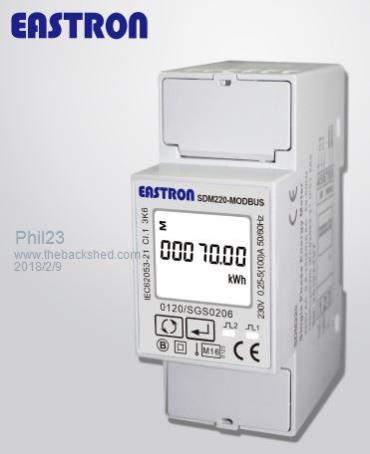

Posted this in the Solar Forum...
Not whether it is best there or here, so linking to the other post for comments.
Phil.

Here are the configurable specs for that unit, I have bolded the defaults:
  Quote  RS485 output for Modbus RTU
...RS485 communication parameters can be configured from the Set-up menu.
Baud rate: 1200, 2400, 4800, 9600
Parity: NONE/EVEN/ODD
Stop bits: 1 or 2
Modbus Address: 1 to 247
Here is a link to the item specs.
They are using MODBUS RTU so data will be bytes of packed nibbles.

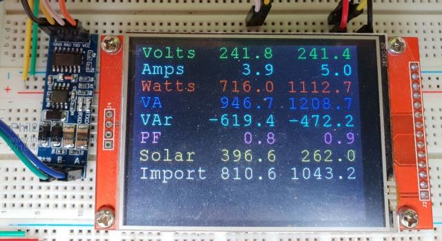

I take it for starters I need something in the way of a converter?
MAX485 module like this ?
Probably a 3.3V version as opposed to 5V.
Edited by Phil23 2018-01-19
SteveA
Joined: 10/03/2017
Posts: 49
Posted: 11:31am 18 Jan 2018
I've used these for pic<->RS485:
https://www.ebay.co.uk/itm/New-3-3V-UART-Serial-To-RS485-SP3485-Transceiver-Converter-Communication-Module/292006059581? epid=1488965693&hash=item43fceade3d:g:z3kAAOSwnHZYgvPx
And for pc<->RS485 this:
https://www.ebay.co.uk/itm/FP-2x-PC-USB-to-RS485-RS-485-interface-converter-Serial-adapter-compatible-PLC/263369403717?e pid=847623220&hash=item3d520a2d45:g:Cy8AAOSw4PxaJ8NK
I managed to get two MM's talking to one another, one would send a command and the other which would turn a led on or off.
I also managed to do the same thing from my pc using the adaptor/dongle.

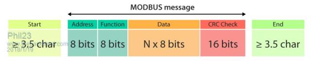

Hmmm,
My brain is pausing when I see that to initialise a device you send it 3 1/2 Bytes...
Not the standard sort of coms I'm used to.
Looking at this page.
Phil.
Azure
Joined: 09/11/2017
Posts: 446
Posted: 12:39am 19 Jan 2018
The start and end framing just requires that you transmit a mark for at least 3 1/2 char times, use 4 if that works better in your mind. Any less can create interpretation errors.
It is also critical that you transmit the whole frame continuously, without any breaks between message bytes or that can cause interpretation errors. There is a minimum intercharacter message delay.
If you create the message to transmit and then output the bytes using interrupts that will solve the continuous message requirement. Before you start a frame you could add a flag and a timer tick to delay the transmission start and a delay at the tranmission end.
Hope that makes sense.
Posted: 12:40am 19 Jan 2018
I think that the 3.5 bytes is the minimum idle time on the buss before and after packets, not a 'start' signal as such.
I have a similar power meter but it only has the pulses which is good enough for me. Saves the brain a bit...

Mostly done & dusted now.
It's polling both meters for live & total values & displaying them on both the LCD display & the VT100 console.
Hardware is the 2 Eastron Energy meters, Micromite, TTL-RS485 module & the ESP-01 to give me an IP connection for the console.
Left column is meter 1; on the inverters input. Right is meter 2 on it's output.
Planning on adding a 3rd to my main meter box supply.
The 2 figures on the Solar line are Meter 2-1; Left is Watts, Right VA.
The Console display still has a lot of debug info to remove, basically request & response strings.
Will post the full code once I've tidied it up a bit more.
Phil.
