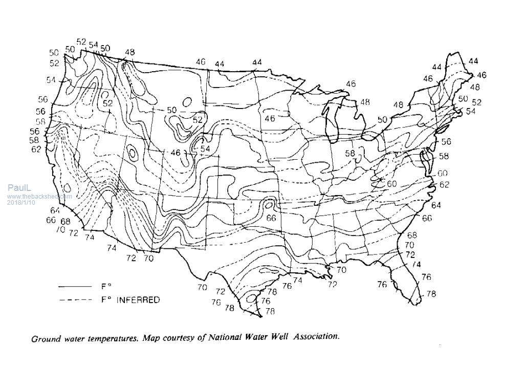

According to some government agency I am located 75 miles north of New York City on the 52°F thermocline which means that at a depth of 7 feet the ground temperature varies from 62°F in September to 42°F in March. That makes it relatively easy to extract heat in the winter and dump heat in the summer.
