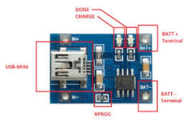

There's quite a lot of little Li-Ion charge modules about.
I use one with a pair of 18650's to run the FARS on my Weather Station.
Some use a TP4056, specifically a charge controller, & many also have a BMS chip (Battery management system), to prevent over discharge.
Have a look at some of these.

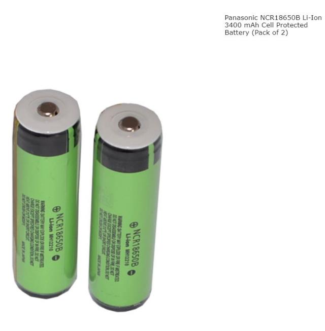

  lew247 said   I've been using 18650 3.7V 3A (3000mAh) batteries ...
Which brand of Li-Ion batteries? Maybe you should check the capacity.

They are genuine 3500mAh Panasonic batteries, and maybe "30" days was a little optimistic

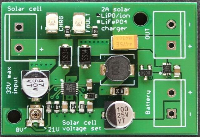

I started off with the Solar cells going into a 5v regulator feeding a TP4056 module to charge the battery, this was working in the summer but now it gets no charge whatsoever as it's winter.
I then bought one of THESE solar chargers but unfortunately it's still giving no charge to the batteries, the sun doesn't seem to be strong enough in the UK during winter
This unit is only giving 1.55V to the battery to charge it which obviously isn't anywhere near enough.
The input from the Solar cells is 14.9V so plenty of voltage, I'm guessing nowhere near enough current though from the sun in this part of the world

I have protected LI batteries with the protection built in
4 of these
I have a 12V solar charger going into this
The charger part is based on the LT3652 solar charger IC and charges lithium batteries (Li-Po, Li-ion, LiFePO4) at a rate of 1000mA (can be set to 2A max)
Tomorrow when the sun is out I'll measure the current coming from the Solar cells
In the summer I was using one of these fev via a 5v regulator to drop the 12V down to 5V
This was working fine during the summer but once autumn came it stopped working, I thought it might be the module so changed it for another and then eventually got the proper solar charging board I'm using now
Edited by lew247 2018-01-09
Posted: 09:42pm 07 Jan 2018
Your charger has a limit of 1 amp at 4.2 volts
Allowing for losses in the conversion, lets call that 5 watts required.
Your solar panel is 25 watts so even allowing for the London smog, there should be plenty available from your solar panel for a reasonable period of the day.
You need to measure the current coming from the solar panel and the current going into the battery with the load disconnected at (roughly) the same time. Also need the battery terminal voltage.
Measuring the output with the battery disconnected will confuse the controller.
With one amps out of the unit, there should be approximately 300mA coming from the solar panel.
If ned be, discharge the batteries a bit so you should be getting the full one amp charge.
The 14.9V you are seeing will be the 'Maximum Power Point' of the solar panel which is set by the trimpot on the controller. 14.9 sounds about right. The rating plate on the panel will have the correct figure for your panel.
