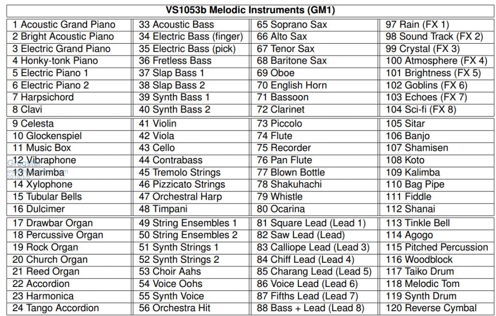

I have an idea for a MIDI sound machine using a VLSI codec chip(VS1053B).
The spec is 8-bit WORDS, but 10-bit BYTES made up of a start-bit, followed by eight data bits, and finally a start/stop bit for framing. See the link above for even more technical information.
The 1053 can also play OGG/WAV/WMA/MP3/MP2 and just about anything else you can throw at it(including FLACC with external DAC), but I am most interested in it for it's MIDI synthesiser. Complete modules can be had on eBay for about US$5 a board from listings like this one.
The device talks to the host MCU using the SPI port, so my first thought was the standard MMBASIC SPI commands, but that does not support 10-bit SPI, only 8, 16 or 32. Next, I looked at the SPI Cfunction, and it DOES let you specify any number of bits per byte up to 64, so this is the one to use.

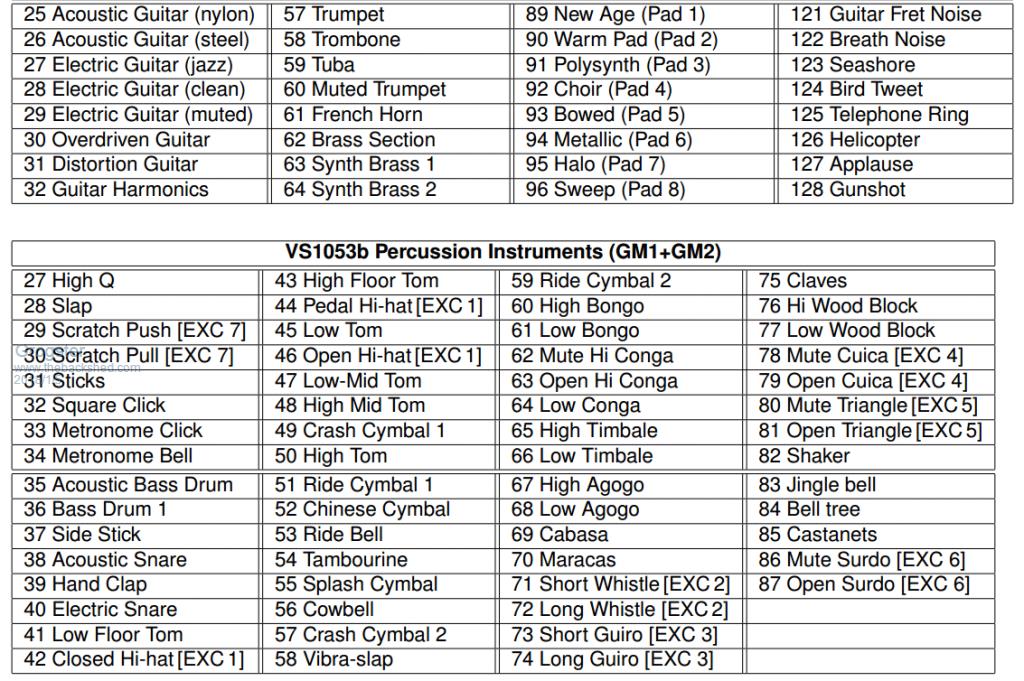

The 1053 gives you access to the following instruments and also a good selection of drum sounds, so a MM-based drum-machine might be coming(using other MM input pins for sensor pads).....
Do any of the technical boys and girls here see any OBVIOUS problem with this concept as it sits now? Perhaps other members have even better MIDI synth chips they know about? Please post if you do.
