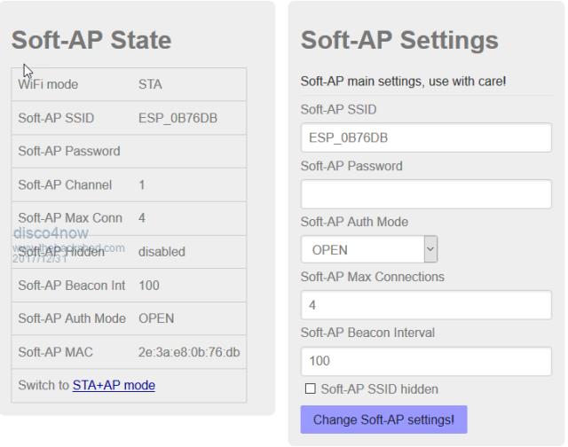

Posted: 01:34am 31 Dec 2017
Set WIFi Mode to STA mode and it wont be an AP anymore.It can be STA,AP or STA&AP which is mostly the current mode.

Thanks Disco
Spent some time reading the esp-link docs and now realise better what is going on. So when the esp is in STA(tion) mode it does not provide an AP (access point) function unless the combined mode is selected.
That seems to address my security concerns if it stays that way. What could cause the esp to switch modes other than my deliberately doing it via esp-link?
