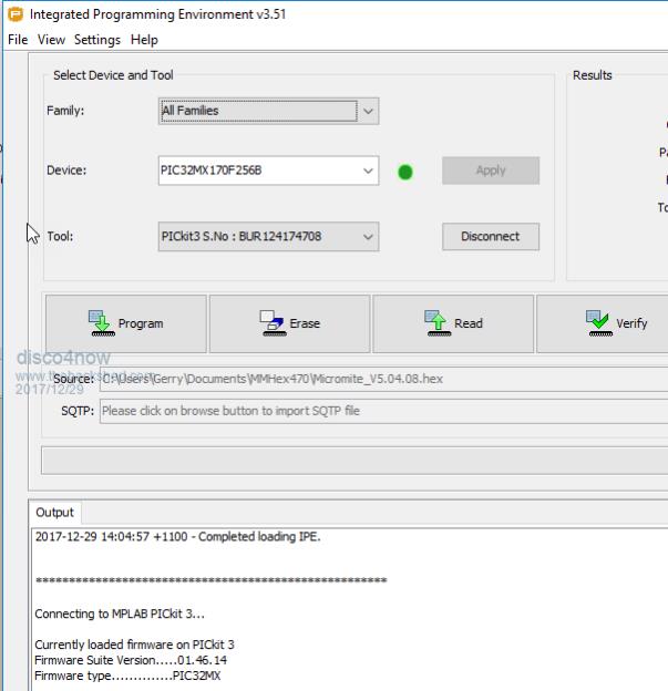

Hi Bob,
Do you have a PICkit 3 adapter connected. If so you need to selected it as the Tool and then connect.The target should be powered up, but have LCD unplugged as it may interfere with some to the pins used for programing. Sometimes I have had the close the MPLAP IPE and reopen before it will connect.
If you don't have a PICKit 3 then have a look here for and alternative programmer and method.
ASCII-ICSP-kit-for-Micromite-and-other-PIC32-MCU-s
Gerry
