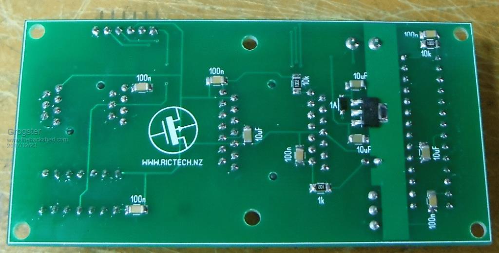

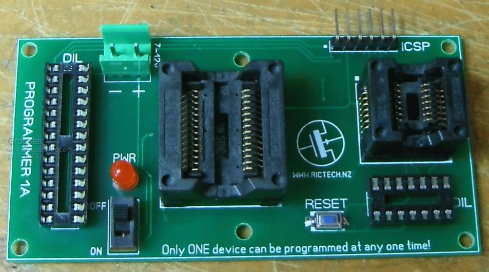

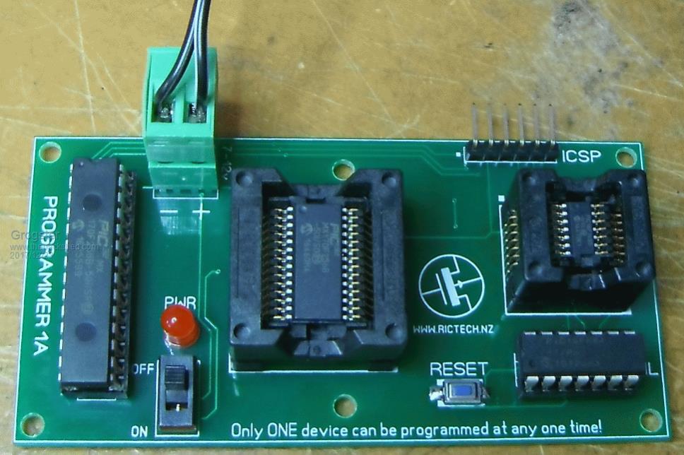

This is what I built myself for Christmas to make programming MicroMite's easier:
It can program any ONE device at any one time, but can program the standard 28-pin chip and the 1455 USB chip in DIL and SOIC flavours. The last photo shows the board fully-loaded with all chips, but you can't actually program it like that, that is just so you can see mainly the SOIC chips loaded in the sockets.
I plan to offer programmed chips on the website next year, but probably only the DIL ones. The SOIC sockets are just to make my life easier for assembly stuff, but if there is any interest, I could keep a small stock of programmed SOIC chips. I see the breadboard-friendly DIL chips being more popular, but that is just me.
If anyone is interested in a constructors pack for this thing, let me know and I will compile one and upload it to my website sometime over the Christmas break.

I got both my soockets from KZT Socket Store on AliExpress - they sell just about anything you can think of socket wise.
14-pin SOIC socket
28-pin SOIC socket
...and they do one for your 28-pin SSOP that you want....
That link is for the SSOP with 5mm body width to match the PIC32 in SSOP, but be aware that you can easily buy the wrong one, as they also do a SSOP28 in 4mm body width, so make sure you either get the one above, or if you are looking elsewhere, make sure the pin-count and pitch are what you need, and ALSO the body width.

Bill - correct. If you don't plan to ever use a certain socket, just don't bother installing it. Essentially, ALL chips PGD, PGC and MCLR lines are connected together so that you can program anything in any one socket - but only one chip at a time.
100x100 PCB's are exactly the same price as 50x100 so there would be no cost difference per board, but 100x100 is bigger then the DLE envelope, so postage would cost more to send to people.
If I made it 150x50 the PCB price also shoots up dramatically(US$27 for ten vs US$5 for ten!). You need to stay inside those two sizes. (50x50 or 100x100)
