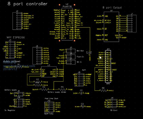

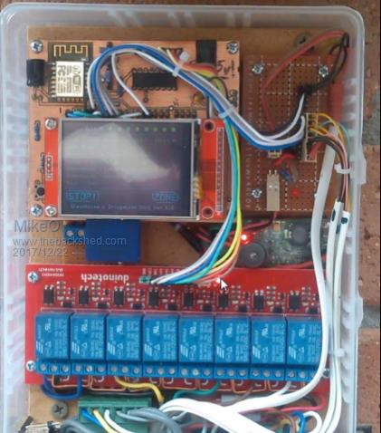

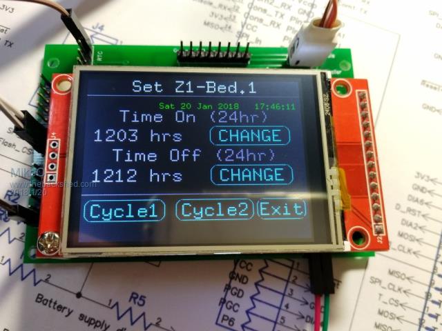

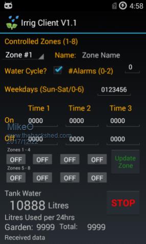

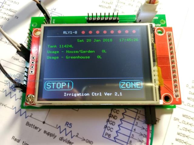

Hi to all the Forum, I would like to wish you all Merry Christmas and all the best for the New Year.

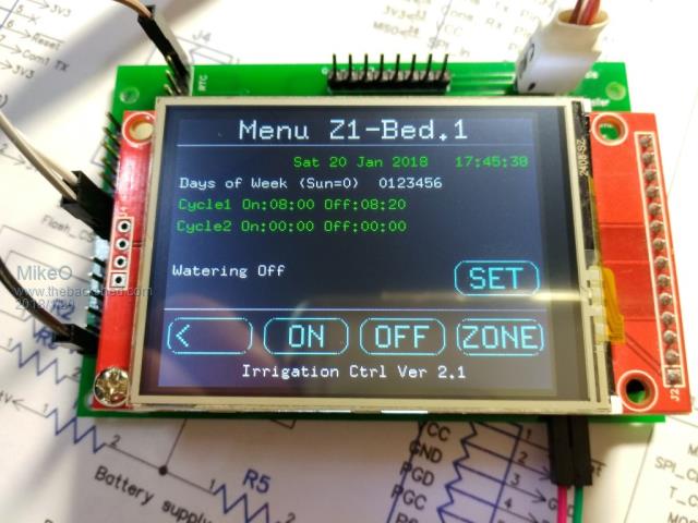

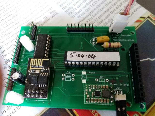

I am currently just completing the a rework of my original MX170 controlled Irrigation System. It controlled 8 Zones (garden Bed watering, Greenhouse functions etc) also monitored the 10,000 ltr rainwater tank and flows. It used to have a 2.4" LCD display with menu system and has now been converted to work headless with communication via Android Phone. The communication is via wifi (ESP8266)and uses the UDP protocol.
Just wanted to know if there is interest in this method of controlling a Mite! if so I can detail this project out to the forum as it could be applied to many situations.
Original controller with display.
New controller
Android Client display.

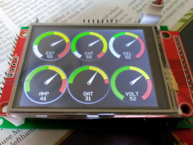

I have also already converted my MX170 weather station data to display to a Android Tablet.
Mike

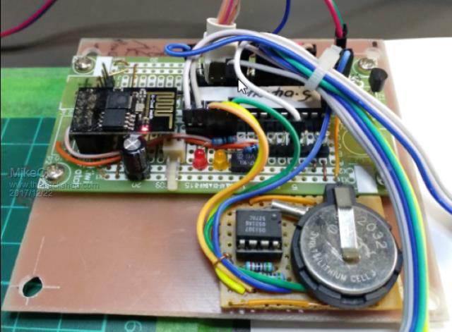

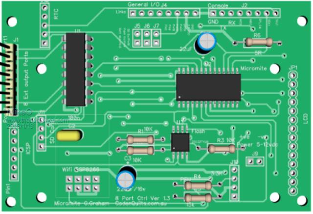

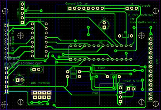

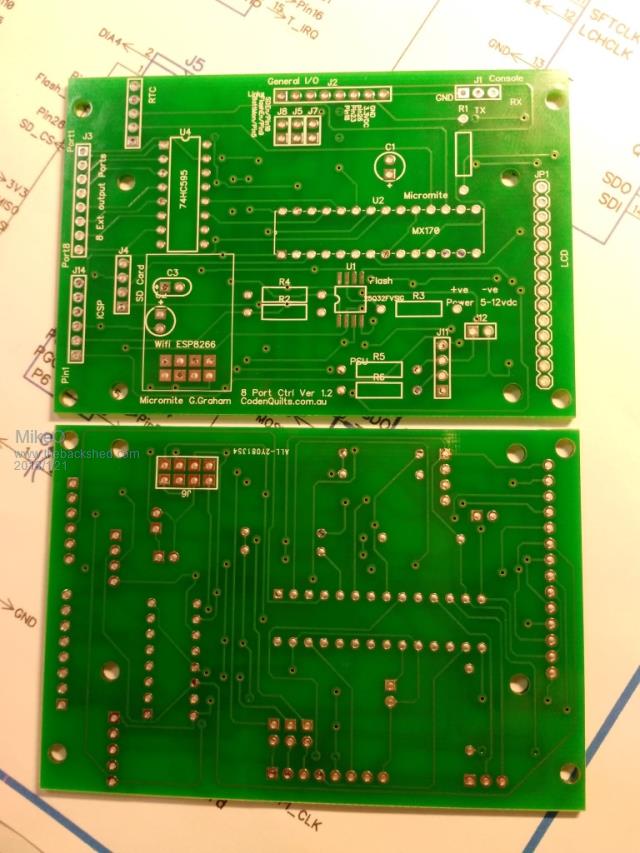

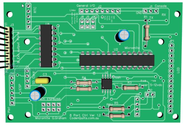

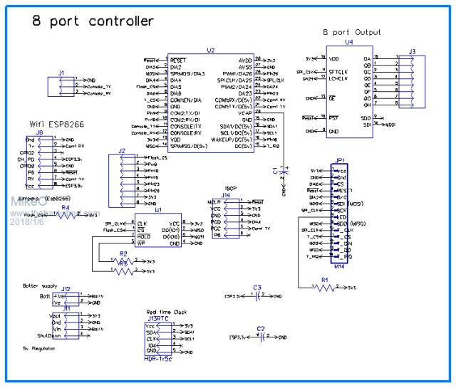

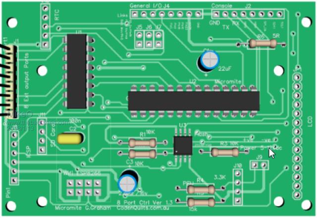

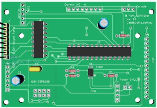

Thanks for the replies, I will get all the various files together over the next week or so. Apart from the Android I have been developing and using the interface components for quite some time so they are reasonably mature and stable. I have used the i/f code for several different projects including weather station and solar/battery monitor. Both of these project have also used an Android device in monitor mode ,ie one way comms only.

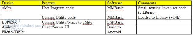

I thought I should outline the concepts. All the MMbasic user programs contain a single small code interface 'hook' plus an optional sub routine for specific interface commands if required.
The code components are as shown in this table.
Communication between the ESP266 (wifi) module and the uMite is via a serial link and the ESP firmware provides UDP ,HTTP messaging and web capabilities, plus built in functions.
I have attached the ESP code to give some idea of the functions available (only a few used are used in the current project) also the Anroid B4A code.
Mike

Sub btnSend_Click
SendMessage ("ESP_Irrig:|ESP_Svr:|uMrconfig|1|"&Chr(13) & Chr(10))

myarray(0)="Zone Z1"
myarray(1)="Zone Z2"
myarray(2)="Zone Z3"
myarray(3)="Zone Z4"
myarray(4)="Zone Z5"
myarray(5)="Zone Z6"
myarray(6)="Zone Z7"
myarray(7)="Zone Z8"
tgtspin.Initialize("tgtspin")
tgtspin.Prompt="Select Box Number"
tgtspin.AddAll(myarray)
Activity.AddView(tgtspin,0dip,28dip,100dip,33dip)
'tgtspin = "Zone #1"
SendIp="192.168.0.255"
Sub SendMessage(sSend As String)
Dim data() As Byte
Dim up As UDPPacket
data=sSend.GetBytes("UTF8")
up.Initialize(data, SendIp, 5001)
usocket.Send(up)
Sub tgtspin_ItemClick (Position As Int, Value As Object)
Log(tgtspin.SelectedItem)
zn=sf.Right(tgtspin.SelectedItem,1)
Log(zn)
SendMessage ("ESP_Irrig:|ESP_Svr:|uMrconfig|"& zn &"|"&Chr(13) & Chr(10))

Update for this project.
I have designed a new board for use as a general control board.
based on MX170 DIP uMite for easy soldering
ILI9341 LCD display support
RTC module
ESP8266 wifi module
4mB of Flash Ram for storage/logging
8 port Ext Output
General 8 Pin connector, 6 general mixed Input/Output/Analog plus 3.3v and Gnd
ICSP connector
Console connector
Pololu PSU module (3.3v), you can choose to use best one for your needs
ie stepup, stepdown, or stepup/stepdown variety. stepdown example
@ Andrew_G you can find most of what you were asking in my post
If anyone wants them all the Gerbers etc are here , I may also have one or two boards available in a few days, $5 plus postage.
Layout 3D Viz and Sch

and for some reason, I am unable to get the gerbers from that Drop Box link. It wont download, giving an error message every time I try. Is this peculiar to me or have others had this problem?
Posted: 01:06am 07 Jan 2018
  Bill7300 said   and for some reason, I am unable to get the gerbers from that Drop Box link. It wont download, giving an error message every time I try. Is this peculiar to me or have others had this problem?
No problems downloading here.
Azure
Joined: 09/11/2017
Posts: 446
Posted: 01:37am 07 Jan 2018
I downloaded shortly after it was posted. No problems, got ZIP file of folder and just checked contents are all good.Edited by Azure 2018-01-08
MikeO
Joined: 11/09/2011
Posts: 275
Posted: 07:58am 07 Jan 2018
Thanks everyone.
Site is OK now was in the middle of a move to another server.
There is a link to the constructor files on the new site if drop box doesn't work.
I should have the boards by the end of the week.
Mike
