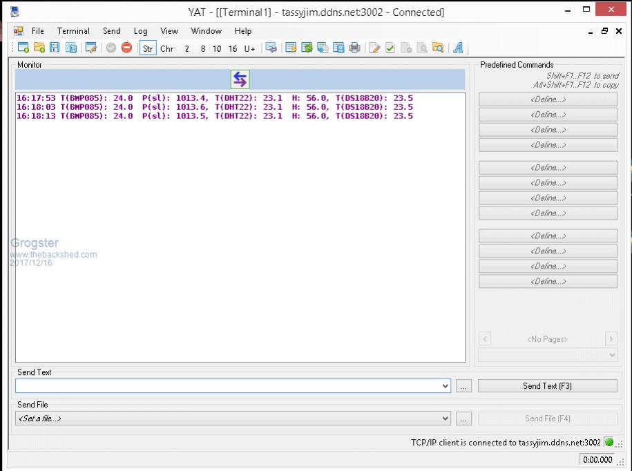

Posts: 10076
Posted: 05:54am 16 Dec 2017
TT flatly refuses to talk to that, but YAT does:
I have yet to work out how to sent CTRL commands(such as CTRL+C etc) via YAT, but it does connect just fine.

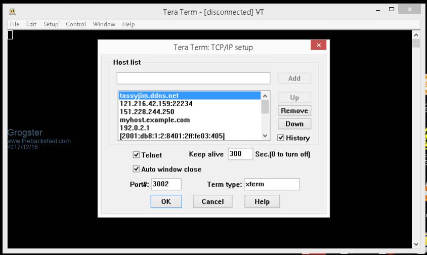

Posted: 06:01am 16 Dec 2017
  Grogster said   TT flatly refuses to talk to that, but YAT does:
I use teraterm all the time, locally and when traveling.
You need Telnet protocol and port 3002. That's all it should need.
Posts: 10076
Posted: 06:03am 16 Dec 2017
Refuses to connect.....
I have also tried VT100 terminal mode - same result: "Disconnected"
EDIT: 'SETUP' window just on image so you can see my setup. I did try clicking OK....Edited by Grogster 2017-12-17
Posted: 06:13am 16 Dec 2017
Terminal type shouldn't matter
Your settings look OK so I have no idea why it doesn't connect.
Posts: 10076
Posted: 06:22am 16 Dec 2017
We'll put it down to a TT oddity.

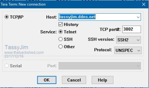

Posted: 06:36am 16 Dec 2017
V4.94 but I have used earlier version without issue.
You were connecting by using "New connection" from the file menu?
Azure
Joined: 09/11/2017
Posts: 446
Posted: 06:44am 16 Dec 2017
I can connect to it in TT.
In the file menu open new connection, select the TCP/IP port you setup in settings and enter port 3002 and telnet as session and it connects.
I am not sure what it is supposed to do, just seems to be send a loopback of what I type when I press enter.
Posts: 10076
Posted: 06:50am 16 Dec 2017
@ Jim - Used 'New connection' put in that information: 'Connection timed out.'
@ Azure - Yep, same process here, but it rejects the connection. Timed out.
I don't really care - I was just playing around.

Azure
Joined: 09/11/2017
Posts: 446
Posted: 08:18am 16 Dec 2017
@Grogster
I noticed when you select the telnet option it changes the port number you may have already typed in. It will timeout trying to connect to that port.
Sequence is:
Select TCP/IP and tassy...
Select Telnet option
Enter port 3002
Hope that helps.
