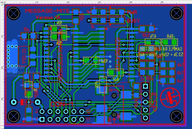

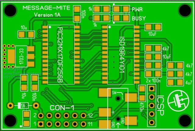

Here is my latest MM board:
This board uses a MM2 as the controller, paired to a ISD1964SYI01 message recorder/playback chip.

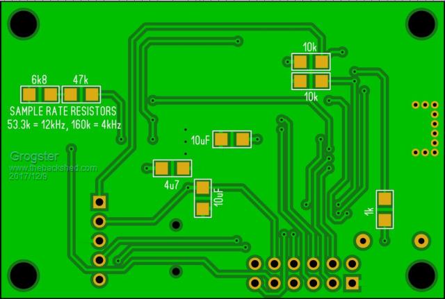

This chip costs six bucks and can be configured for 1-8 messages. The more messages, the less the message duration per message. With the 1964 chip, you can get eight messages up to about 8 seconds each at 12kHz sample rate. Sample rate can be changed with simple resistors, with a lower sample-rate resulting in longer messages of lower sound quality. The '01' type chip has line-level output, rather then speaker output.

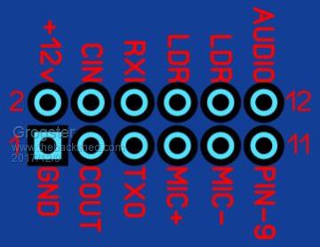

Control of all message playback and recording is done via commands sent to the MM2's COM1 serial port, at any supported baud-rate you prefer. It is done this way to minimize the external connections to the board, but still provide full control over playback and recording. I also wanted to have a waterproof socket on the box as it will live outside, and has to be waterproof, so a waterproof socket with the least number of pins on it is preferred and also is cheaper.
