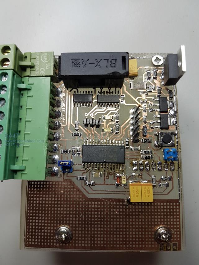

I need some suggestions of what to try next. I have a project PCB (home made single sided) one of the 5 I have made refuses to communicate thru the Console port. I initially went through a fairly thorough check of all of the solder joints and found no issues. I have continuity tested the tracks from the console pins to the chip and tested for shorts from either track. In desperation I have removed the radio unit and replaced the Micromite chip, re-programmed it and can see it boot into the program (Autorun is on). I am using a USB-Serial converter and I can see the LEDs on it flash when I try to communicate with the chip. The PC, USB-Serial and cables work fine on another unit so I am at a loss as to what to try next. Wondering if any shedders have had similar problem that they may have solved? I will post a photo of the unit just in case there is a blindingly obvious error in my construction Please forgive the condion of the PCB/soldering as many components have been removed and replaced

Changed the 10UF X5R Vcap with a 47U Tant but no difference. Got out the multimeter again and less than 1 ohm between the gold plated pin and each of the PIC pins. I checked these measurements with another working unit.
Interestingly I get around 19K from pin 11 OR 12 to gnd on a working unit but on the faulty unit I get 19K to gnd on 12 but 10k on pin 11. will investigate further.Edited by OA47 2017-12-01

Thanks again for your help Grogs. There is a track that goes between the GND pin and the Console PIN 11 pin and there was a small solder blob living under the plastic base of the headers removed the plastic base and all is well in the land of the Micromites.
