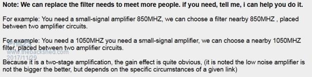

Posted: 08:06pm 28 Nov 2017
This one is 435 Meg.
Wonder if it's re-tunable by changing a few components.
Might be others that are more suitable.
Phil.
Edit:-
Seems from the description it can be reconfigured...
IE,
Edited by Phil23 2017-11-30
Posts: 10076
Posted: 09:20pm 28 Nov 2017
Thanks skyv and Phil.
I have enquired with the Aliexpress seller if their amp can be adjusted to 458MHz.
That would be an ideal solution, coupled into a standard tw-way passive splitter, with each output port feeding a receiver. With a amp gain of 3dB + whatever insertion loss of the amp itself, each receiver should see the same signal level as the original antenna and receiver.
I like the Aliexpress unit, as being band-pass, it will have nice attenuation on all other frequencies - a channelised amplifier, as I used to call them.
A broadband amp would probably work I expect, but being broadband, the amp could also pass through a lot of other spectrum noise which might swamp the receiver if you see where I am coming from. RF is fun, isn't it! (rhetorical!)

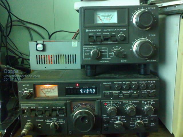

I dont know, I was putting 10w into a mobile antenna that I couldnt get under 1.7:1 with fm with no issues, but then it was a tr9000, and they were built like a tank
Nice little radio, until somebody stole it out of my car
My other baby
Still got it (in storage atm) and still got that homemade PSU, an old atx psu, put a mains switch in the hole where all the cables came out, fit a 12v 7w tail light bulb to the 5v and gnd wires and bingo instant 12vdc 20a psu for next to nothing, and with very little to no noise coming through the transceiver surprisingly, no extra filter caps fitted at all
