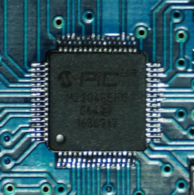

It really is all in the technique, assembling SMD, especially that QFP chip.
0.5mm pin pitch is rather unforgiving of incorrect technique, to much solder(or solder paste) or too much heat. You really MUST have AT LEAST 10x magnification to have any chance of success. A 3x or 5x illuminated magnifying glass generally speaking WON'T cut it, as you can't see close enough to the chip pins to be sure there are no solder bridges etc. That's why I use a microscope. 10x for assembly, then I rotate the objective lens for 30x zoom in to check there are no bridges, and that all the joints are good.
If you want to send me the two that don't work, I will see if I can get them going for you for free - flick me a PM if you want to proceed.

I do all my soldering under a 3x magnification desk lamp/magnifier. It is perfectly good enough for 0.5mm pitch. I never use solder paste but I do use very fine multicore solder (0.25mm). I use a standard fine tip iron and solder the pins individually typically 3 pins per dab of solder. (others use different techniques equally satisfactorily). It really isn't necessary to spend on things like a stereo microscope.
The three times magnification is enough to see most solder bridges but it is easy to check for any hidden ones using a cheap USB microscope or just your camera. These are easy to clean up with good quality desoldering braid, I use RS 561050 . Typically on a 64-pin I wouldn't more than 1 or two bridges at the most.

I am getting pretty ancient too, and my eyesight is getting steadily worse, I try to avoid the really fine pitch packages and stick with the larger through hole parts and now use sockets for all my ICs.
But there is a bit of a trick to soldering fine pitch packages.
I agree, solder paste is probably not the best technique for do it yourself fine pitch components at home.
Much better is to initially flood all the pins with resin cored solder, and then use solder wick to remove the surplus solder. If you remove too much, its easy enough to put some back.
But with a bit of practice, its possible to very quickly make some pretty lean joints leaving minimum solder remaining. Just enough to see on each pin without any possibility of solder bridges.
If you have fifty pins per side (or whatever) just run down each side with big solder and a big tip.
Its not necessary to solder each pin individually !
Then run down each side with solder wick sucking up the excess.
In just a few seconds its possible to have fifty very neatly soldered pins sitting in a morass of surplus flux. I think that is probably the secret. The solder wick is saturated with flux and leaves a nice shiny solder fillet, as long as you don't remove too much solder.

Solder paste is good if you have a stencil and a reflow oven. I don't like it for manual soldering with an iron. IMHO, you are far better off with fine solder, and some decent flux.
I have had issues in the past with the "Flooding" method, where you just add a whole heap of solder to all the pins and short them all out in a big line of molten solder.
Wicking the excess solder out from between the pins can be a real problem with fine-pin-pitch stuff, as the surface tension can sometimes make tiny little solder hairs stay BEHIND the pins where you can't get at them with the wick. This again, is just MY thoughts on it, and certainly not raining on the parade of those who like that method.

Another somewhat controversial trick involves precise positioning of the chip over the pads. Success in soldering requires the pins to be very precisely centered over the pads, and that is not so easy to do.
A very small spot of your favorite glue under the chip will allow you to move the chip around with maybe a pin or a needle under your microscope until its exactly in position.
Then go away for a while and allow the glue to set.
The chip should then not move if a few corner pins are then very delicately soldered first.
Old age brings us patience, as well as sometimes poor vision and/or the shakes!
So its a bit of an old fart's trick that the young guys laugh at.
But it does help a lot.
Its not necessary to bury the chip in high strength epoxy, just a small spot of something less permanent that can easily be prised apart later if necessary.
