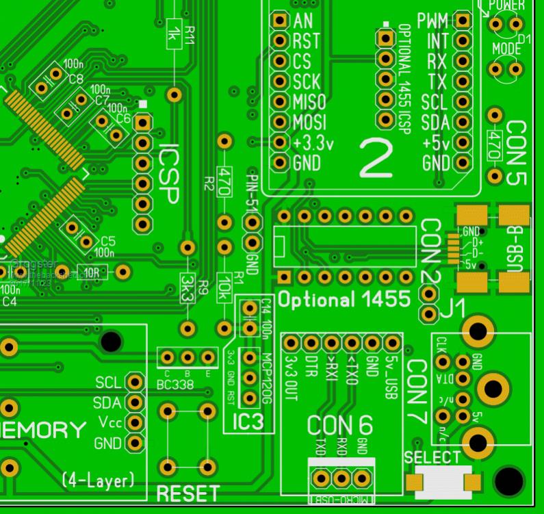

Version 1A was the prototype - only a few people have that one.
Version 1B was the first official release - most people have that one.
Version 1C adds the on-board 1455 USB interface.
Version 1D will have the 1455 also, but I am planning to get rid of the footprint for the CP2102 USB-serial module(which is optional anyway), and also planning to discontinue CON6, which is the standard console pins, because these are now directly connected to the 1455 USB interface, so there should be no need to have them anymore, as the console now effectively has become a native USB connection as standard now on any MM using the 1455 chip.
Do any of the members here have any major problems with that concept?

Hi Grogs,
Three things to run past you for consideration:
1> Can you please remove the LED colour names from the silkscreen!
2> Is it worth adding a uSD socket (as with the SC version of this PCB)? Then you can loose the SD header (CON10 I think it is?)
3> Any chance of making it double layer rather than 4-layer? (just asking!)
Cheers buddy.
WW
Posts: 10076
Posted: 04:24am 21 Nov 2017
#1 - I added them cos I was always forgetting which LED went where. Why do you want them removed?
#2 - Not a silly idea. I will look into it.
#3 - Not a chance in Hell.
Posted: 08:13am 21 Nov 2017
  Quote   #1 - I added them cos I was always forgetting which LED went where. Why do you want them removed?
I do not like using red LEDs to indicate power (prefer to use them more for 'warnings' - just a silly thing I have).
I like to use green or blue to indicate Power ON). The sequence that works well on the E100 is a traffic like (i.e. from top: Red, Yellow, Green). I still supply assembled E100 units in this sequence but often get customers tell me I put the LEDs the wrong way round!!
  Quote  #2 - Not a silly idea. I will look into it.
  Quote  #3 - Not a chance in Hell.
I guessed that would be your 'polite' answer (but it would massively reduce PCB cost). As the leading PCB expert here, are you sure you don't want this PCB challenge?

Posts: 10076
Posted: 08:16am 21 Nov 2017
#1 - Ahhhh. I see what you mean now. Fair enough. I would still like to label them, so I will label them as you suggest. Satisfactory?
#2 -
#3 - I like a challenge, but that is impossible. If you are making a custom board, then two-layer IS quite pissable, but as the E100 has so many features on it, four-layer.....C'est La Vie....
Posted: 08:21am 21 Nov 2017
#1 - make sure you don't turn the PCB 180deg when relabelling! Yep - very satisfied
#2 - uSD ok then, or not yet attempted?
#3 - I understand - but worth asking . . .

#1 - OK.
#2 - Not done yet, but agree with your big-grin.
#3 - On the E100, just not really possible, with I/O lines going everywhere.

  Grogster said   planning to discontinue CON6, which is the standard console pins,
Just my 2 cents worth I would prefer to keep the standard console pins this way the board is usable with OR without the 1455 (The CP2102 should be removed)

Posted: 09:29am 21 Nov 2017
It would be useful to have a feature to 'disable' the PIC1455 when not required (to minimise current draw).
I have spoken to Peter about this and he implied to put a link in the 0v line to the PIC. I think it may still see a route to Ground through the other connections to the PIC1455 so am not yet convinced it will draw zero power with just a GND link.
On that basis - I agree with man to leave in the three basic console connections (GND, Rx, Tx)
Posted: 01:10am 22 Nov 2017
the 1455 draws about 10mA, how does this compare with the other stuff on an E100 board?
i'd really not recommend lifting the ground pin of the 1455. a far safer approach would be to socket the 1455 (ie, use a DIP version). alternatively, discuss with peter ways for the 1455 to be persuaded into a low-power sleep mode. this could be signalled, for instance, by having the mode/select pin held low at powerup - a simple jumper across the select switch would then suffice. this would, of course, require a modification to the 1455 firmware, and is dependant on such a change even being possible.
we are currently on version 1.18, with an upgrade fairly straightforward as just about all the 1455s out there included the ds30 bootloader. it would be a useful upgrade for E-28 boards too, as they have a couple of pads right next to each other for mode/select and ground.
rob :-)

Posted: 01:21am 22 Nov 2017
@ jman - OK, I will keep CON6, but get rid of the CP2102 module footprint.
@ WW - On the E100, is low-power really even a thing? With the E28 or a custom design using a MM2 I can certainly see why you would want low-power mode for battery operation, but the E100 with it's thirsty LCD screen makes the 10mA or so of the 1455 chip negligable I would have thought....
@ Rob - Yes, a DIL socketed IC would be the best way forward with that. There MIGHT be room for that as an idea - I will look into it, then if you want the 1455 interface, you just plug in the 1455 DIL chip. If not, remove it.
I realise that to some extent I am opening myself up to design-by-committee again here with this thread, but so far I am happy with suggestions.
That is not a cue for members to start suggesting flux capacitors and time circuits....... Edited by Grogster 2017-11-23

Phil23
Joined: 27/03/2016
Posts: 1667
Posted: 08:05pm 22 Nov 2017

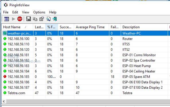

  Grogster said  Do any of the members here have any major problems with that concept?
ESP-8266 users will be compromised.
On mine I use the CP-2102 header for a plug to connect the ESP-01 as I mentioned here....
I could live without that particular connector, but as long as I still had access to Tx & Rx before the 1455, as on Con6.
All my MM's including the E100's are connected by Wifi & I'd be totally lost without that functionality.
Having to take a laptop & USB to all of them for code changes would be a huge PITA.
at should still be available via some means.
Think this applies to all devices using the 1455; Direct Tx & Rx Needs to still be available.
Phil. Edited by Phil23 2017-11-24
Posts: 10076
Posted: 10:32pm 22 Nov 2017
OK folks, thanks.
And Phil - you make a very good point, and hammered home well with the photos.
I think what I will do, is leave the CP2102 header and CON6 there, but perhaps change the SOIC 1455 to a DIL version, so that if you want the USB serial connection and/or the ASCII ICSP feature, you plonk the DIL chip into a socket on the E100 board.
I think that would then cater to everyone. Those that DON'T want it cos they currently have arrangements such as Phil, but also those that DO want that extra feature. This also means just one version of the PCB.
So, that is how I am going to proceed.
- CP2102 footprint will stay.
- CON6 will stay.
- 1455 will change from SOIC to DIL and socket
- Silkscreen changes to LED's as suggested by WW
- Add uSD card socket as suggested by WW.
It was worthwhile posting this thread.
Posts: 10076
Posted: 12:17am 23 Nov 2017
OK, DIL 1455 mod done. I just have to do the other suggestions.
Install the DIL 1455 in the socket if you want the USB console and/or ICSP programming ability, don't install the chip if you don't want that ability and would rather use the CP2102 or CON6. I think that best deals with every situation, yes?(rhetorical!)

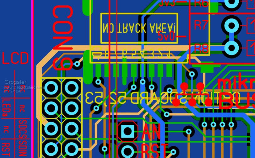

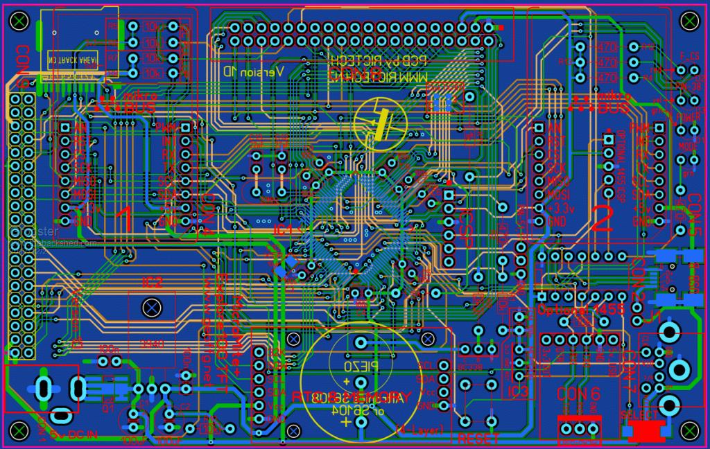

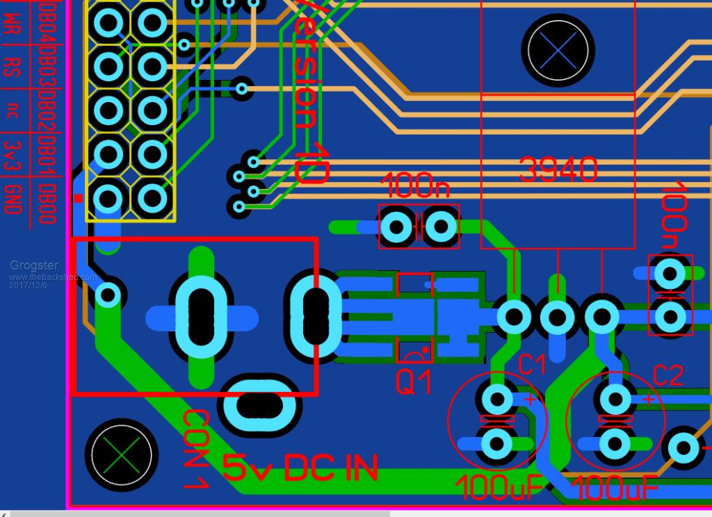

Posts: 10076
Posted: 01:02am 02 Dec 2017
UPDATE:
OK, here we are with the new design.
- Optional socketed 1455 USB/ICSP interface chip with on-board ICSP for IT
- Silkscreen changes as per WW request(around LED's)
- uSD card socket added(SD #2), upper-left corner.
- CON10 removed.
- PIN_17 added to PIN_51 header as a spare I/O pin.
I will probably tweak a few more things, but this is essentially the new version of the board I plan to get made.
