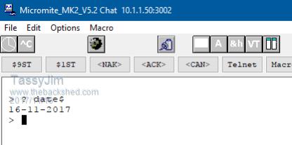

? MM.VER
5.0405
> ? DATE$
0
Error: Syntax
> ? DATE$()
0
Error: Syntax
What do I get rid of?

make sure there is a space after ?
try
print date$

Found it. The problem occurs in MMEDIT / VT100 mode!
@Tassyjim?

  drkl said   The problem occurs in MMEDIT / VT100 mode!
@Tassyjim?

BASIC is sensitive to the placement of spaces but in the next version one of the additional features will be more tolerance for missing or extra spaces. For example, a space will not be required after a ? (the above issue) and extra spaces after an array name and before the opening bracket will not cause an error.
