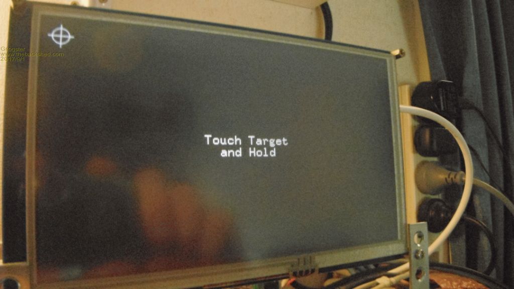

  lew247 said   I thought on the test it drew the touch points
top left top right bottom right bottom left?
It does.
These are normal results. Yours are really badly off.

The problem was the touchscreen
Luckily I had a spare put away somewhere, found it and connected it and it works great
The buzzer even beeps now when the screen it touched :)
