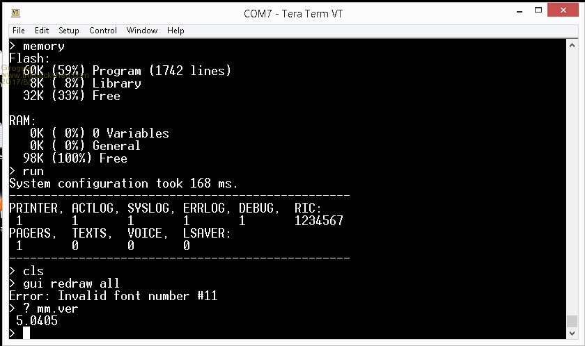

This doesn't work for me in "plus MMBasic Ver 5.04.05" on an E100. I'm not concerned as I just list the controls instead.
GUI REDRAW ALL
Error: Invalid Font number #13
GUI REDRAW XX or GUI REDRAW X1,X2,X3 is OK.

Confirmed.
Interesting. I am getting a font #11 error, but the same kind of error, and I don't have a font #11 installed. This is on an E64 module with 7" LCD.

Yes I'm the same - different font error between local KB and USB console, so obviously that is not the actual problem.
