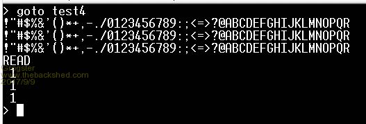

I have my 11AA160's, but I can't get them to read.
Using Jim's code:
[Code]
Test4:
OPTION EXPLICIT
OPTION DEFAULT NONE
DIM C$,NAME$,NAME1$ AS STRING
DIM STATUS AS INTEGER,LAB AS INTEGER
LAB=14 'I/0 PIN
'UNIO ROUTINE IN LIBRARY
MAIN:
GEN_STR(50,NAME$)
PRINT NAME$
WR_UNIO(1,50,NAME$)
GEN_STR(50,NAME$)
PRINT NAME$
WR_UNIO(52,50,NAME$)
PAUSE 10
GEN_STR(50,NAME$)
PRINT NAME$
WR_UNIO(103,50,NAME$)
PAUSE 10
PRINT "READ"
RD_UNIO(1,50,NAME1$)
PRINT status,NAME1$
RD_UNIO(52,50,NAME1$)
PRINT status,NAME1$
RD_UNIO(103,50,NAME1$)
PRINT status,NAME1$
END
DO
LOOP
'---GENERATING A STRING
SUB GEN_STR (LENH AS INTEGER,NAMES$ AS STRING)
LOCAL INTEGER I
NAMES$=""
FOR I=1 TO LENH
NAMES$=NAMES$+CHR$(I+32)
NEXT I
END SUB
'LAB: THE PIN, GLOBAL VARIABLE, STATUS GLOBAL
'---READING A STRING FROM UNIO: BADDR-BEGINADDR, LENH-GIVEN LENGHT, NAMES$-THE STRING
SUB RD_UNIO(BADDR AS INTEGER,LENH AS INTEGER, NAMES$ AS STRING)
LOCAL n AS INTEGER
FOR n = 1 TO 10
STATUS = UNIO(LAB,01,BADDR,LENH+1,NAMES$)
IF status =1 THEN EXIT FOR
NEXT n
END SUB
'---WRITING A STRING TO UNIO: BADDR-BEGIN ADDR, LENH-GIVEN LENGHT, NAMES$-THE STRING
SUB WR_UNIO(BADDR AS INTEGER,LENH AS INTEGER, NAMES$ AS STRING)
LOCAL n AS INTEGER
FOR n = 1 TO 10
STATUS = UNIO(LAB,02,BADDR,LENH+1,NAMES$)
NEXT n
END SUB
[/Code]
The results I get are all success codes(1), but no data:
MMBASIC 5.0405 on 170 chip.
According to Jim's example code, I should be getting the ASCII string back along with the "1" for success, but I am not.
100k pull-up to 3v3 on I/O pin, 100n across device.

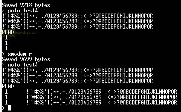

Posted: 01:45am 09 Sep 2017
Are you using the latest CFUNCTION?
From page 3.
Posts: 10076
Posted: 01:52am 09 Sep 2017
That's a bloody good point - standby.....
Ahhhhhhhhhh!!!!!!!!!!!!
The experimentation can now continue - Thanks, Jim. Edited by Grogster 2017-09-10
