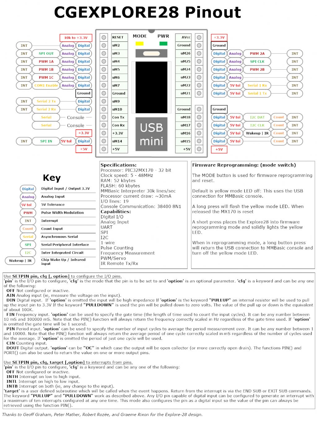

The image and PDF below is a 1-page pinout reference for the Explore-28. If you see anything wrong, please let me know.

Posted: 07:32am 02 Jul 2017
Is it not worth labelling Pin 1 as 'Reset' instead of '10K to +3.3V'

Posted: 07:34am 02 Jul 2017
  WhiteWizzard said   Is it not worth labelling Pin 1 as 'Reset' instead of '10K to +3.3V'
It is RESET on the inside of the board graphic.

Posted: 02:17pm 04 Jul 2017
strictly speaking, AVcc should be described as "10ohm to +3.3v".
rob :-)

Posted: 03:12pm 04 Jul 2017
  robert.rozee said   strictly speaking, AVcc should be described as "10ohm to +3.3v".
rob :-)
Thank you! I'll make that change.
