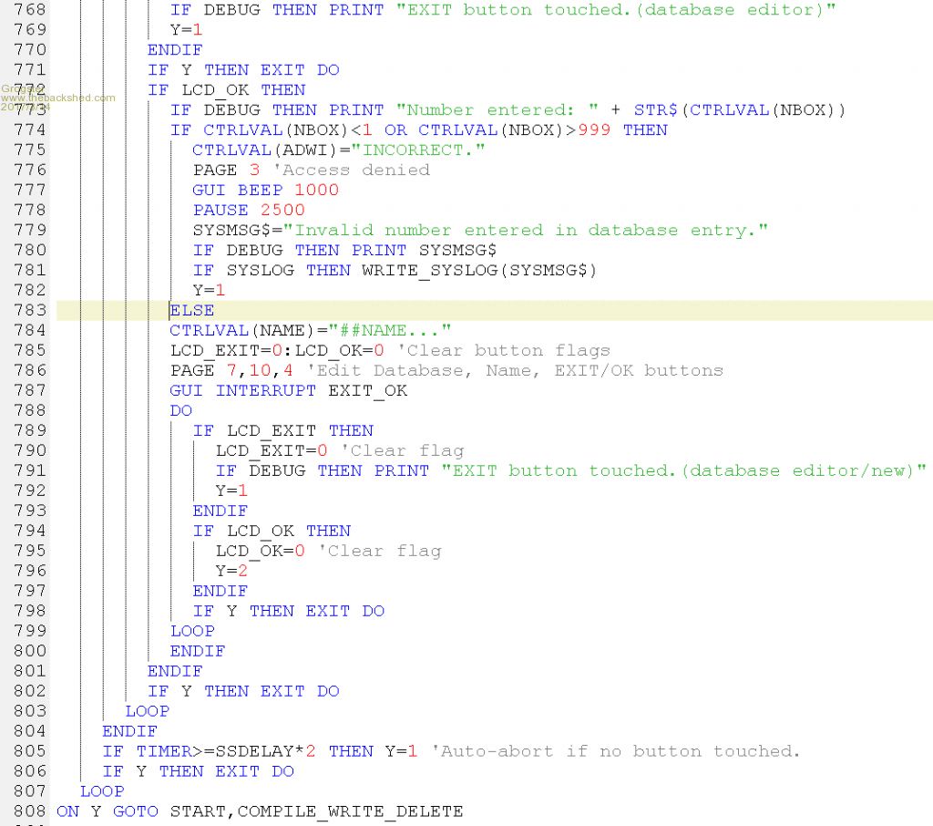

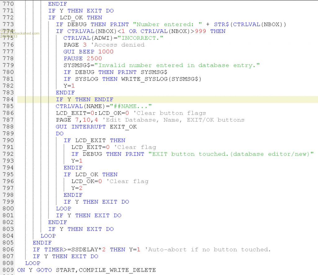

Hi there.
I am just trying to clean up my code that at the moment uses GOTO out of loops.
DO and FOR are taken care of with EXIT DO and EXIT FOR respectively, but there is no EXIT IF command, so I am "Making one" via a flag and ENDIF.
In other words, IF Y THEN ENDIF kind of idea.
Is this acceptable?
What I DON'T want to do in my attempt to clean up all my loops, is introduce ANOTHER bad practise in the process!
A code sample:(not wanting anyone to re-write this, it is only for context of the ENDIF idea)
The yellow highlighter bar in this GIF image, shows the line I have concern with.
Prior to this week, all my loops had 'Dirty' exits, by GOTO'ing out of the loop, which is a bit naughty, so I am cleaning up all the code now so that ALL loops have a clean exit, and one single ON x GOTO concept at the bottom, and I just use flags('Y' in this case) to signal that exits need to happen at a given point. This all seems to be working fine.
FOR/NEXT is easy to deal with via EXIT FOR.
DO/LOOP is easy to deal with via EXIT DO
Multi-line IF/THEN exits are a little different.
So, looking at how I have written my exit using a flag and an ENDIF - is this acceptable, or is there another(better!) way?
I have quite a few of these multi-line IF/THEN's to change, so I only want to do it once.
Bizzie

I'm fairly sure it won't work, because ENDIF is lexically matched with its IF. You'd want the equivalent of EXIT IF (which I think doesn't exist).
I'm not sure in your code where you'd want it to go. If it's where I think then you could use EXIT DO instead, I think.
Or, it looks like you could change the line concerned and the ENDIF above into ELSE (and the ENDIF further down).

In MMBasic ENDIF does not actually do anything when it is executed. It only exists as a marker so that the interpreter can scan forward to find the end of the IF statement. This is used when the IF test is false, in that case the interpreter will scan forward looking for the matching ENDIF and resume execution after it.
Putting the ENDIF at the end of an IF will just confuse the interpreter because it cannot evaluate the IF while scanning.
The bottom line is... DON'T DO IT

Posted: 03:23pm 13 Mar 2017
OK, so I won't mod anymore IF/THEN's like this.
Having said that then, how do you exit from a multi-line IF/THEN cleanly, WITHOUT an EXIT IF command?
It may well be do-able with MMBASIC as-is, but I will need a little prod as to how this is done if that is the case.
Using my example above, what I am trying to do with the highlighted line, is exit totally out of that IF/THEN, down to line 803(technically then to 805).
IE: At line 784, what I need is something that can do the same as IF Y THEN EXIT IF, resulting in the code dropping down to line 803 in this example and continuing from there(and then dropping out to line 805).
Based on what has been written above, and if ENDIF is simply a marker for the interpreter and does not "Do" anything in terms of code processing exactly, can I just use EXIT DO as JohnS suggests? This will drop me right out of the IF/THEN and it's hosting loop. If that works, that is fine with me - so long as that is still considered a clean exit, yes?
EDIT: In other words, can I use IF Y THEN EXIT DO at line 784, to effectively drop me back out to line 805?Edited by Grogster 2017-03-15

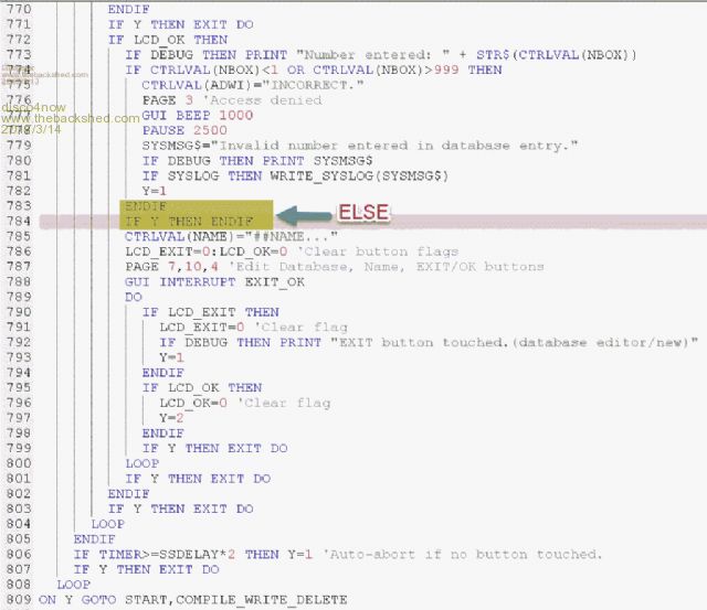

The construction below is useful if you want to test for multiple things
IF blah THEN
ELSE IF blah2 THEN
ELSE IF blah3 THEN
ELSE
... (none of above)
ENDIF
I think the ELSE statement to replace the two highlighted lines might get you close.
Gerry
F4 H7FotSF4xGT
Posted: 05:41pm 13 Mar 2017
Hey, I think you are on to something there, Gerry!
Made the change you suggested(replaced those lines with an ELSE), and the code works exactly as expected. This seems like the way forward, yes?
