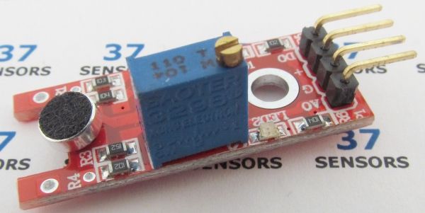

If it is one of these sensors:
There is a digital output on the sensor. This is a threshold output that is adjustable by the potentiometer on that board. That would be usable as an input to the Micromite.

Mine doesn't have the adjustable pot.

first i would use an ADC input channel with a potentiometer ( adjustable resistor ) to test it

You might sample the speaker signal (use an analog input), perhaps every 200mS, and look at the level of the signal over a specific threshold.
You could even use another analog input and a potentiometer to make an adjustable threshold level.
