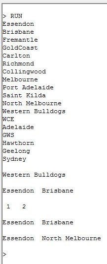

I think it would be a lot easier if you change the format of your data.
Essendon = 1
Brisbane = 2
Fremantle = 3
GoldCoast = 4
Carlton = 5
Richmond = 6
Collingwood = 7
Melbourne = 8
PtAdelaide = 9
StKilda = 10
NorthMelbourne = 11
WesternBulldogs = 12
WCE = 13
Adelaide = 14
GWS = 15
Hawthorn = 16
Geelong = 17
Sydney = 18
DIM STRING city.name(18) = (" ","Essendon","Brisbane","Fremantle","Gold Coast","Carlton","Richmond","Collingwood","Melbourne","Port Adelaide","Saint Kilda","North Melbourne","Western Bulldogs","WCE","Adelaide","GWS","Hawthorn","Geelong","Sydney")
for loopa = 1 to 18
PRINT city.name(loopa)
NEXT loopa
PRINT " "
PRINT city.name(WesternBulldogs)
PRINT " "
READ A$, B$
PRINT A$, " " , B$
PRINT " "
DATA "Essendon", "Brisbane"
READ C, D
PRINT C, " " , D
PRINT " "
DATA Essendon, Brisbane
READ A$, B$
PRINT A$, " " , B$
PRINT " "
READ C, D
PRINT city.name(C), " " , city.name(D)
PRINT " "
DATA Essendon, NorthMelbourne
This is the output:
Edited by CircuitGizmos 2017-01-25
CircuitGizmos
Joined: 08/09/2011
Posts: 1427
Posted: 01:49pm 24 Jan 2017
Not sure why my code isn't colored. Why does it work for TassyJim?
