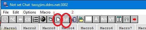

I think you might get better results if you use LOAD in Chat instead of 'load and run'
Press "NEW"
Wait for the prompt ** very important to wait for the prompt.
Press "Load"
This uses 'autosave' to load your program instead of xmodem but your problem is with the initial communications with the micromite, not xmodem.
