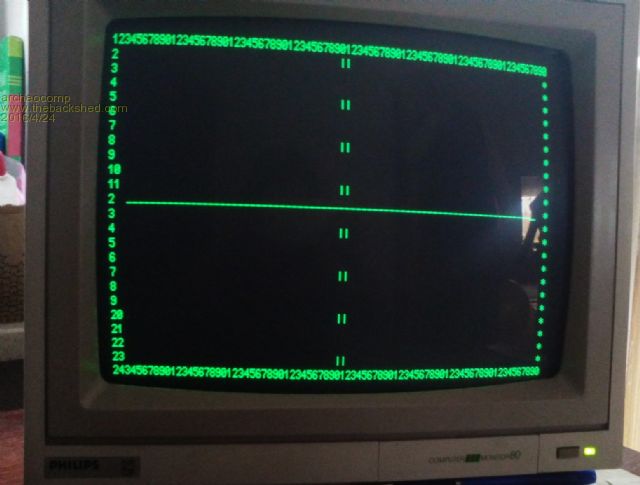

archeocomp
Joined: 17/04/2016
Location: Slovakia
Posts: 4
Posted: 04:41am 24 Apr 2016
It actually already works. Strange, it was too easy. I am sure some timings are out of specs. But I can now have "almost authentic feeling" CP/M machine with real green phosphor 24 rows x 80 columns VT100 compatible terminal and two 5.25 inch drives (btw). Monitor used is Philips BM7502.
