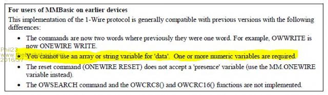

Hi Geoff,
Just a minor manual thing. page 90.
Maybe move this line out of the:-
"For users of earlier Versions box".
I skipped over the detail of the section a I considered myself not an earlier user, and tried to use arrays.
Phil
