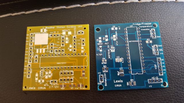

lew247
Joined: 23/12/2015
Posts: 1709
Posted: 01:06am 26 Apr 2016
I've got to highly recommend http://www.pcbgogo.com/
I've had about 6 lots of boards made by them now.
They are always efficient, best of all cheap and are very very helpful either by email or online chat and can usually help with almost any problem you put their way.
The last lot of boards was finished on Friday in China and was delivered yesterday Monday by DHL (well they tried to deliver but I was out - it's coming today)
If the cost of postage including import duties is too high - email them and they'll do their best to help.
Sample of their pcb's I had done
Edited by lew247 2016-04-27
