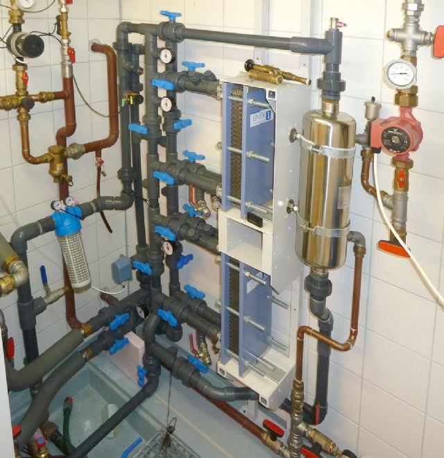

Posted: 10:13am 11 Apr 2016
Paul,
I live close to Vienna at about 170m altitude
Weather differs a lot over time - generally getting warmer the last years
But we had years with -20 Centigrade for a full week
Now we have summers with + 35 every day for quite a few weeks
So cooling becomes equally important
My house is rather massive double shell brick with good insulation in between
The heated floors are about 250 sqm with 7-10cm of concrete & natural stone
I need about 6-8kW of heat at -20 degrees
The heatpump delivers 11kW - consumes 2kw + 1kW for the waterpump
(This 1kW is a sore point, I will reduce this to less than 250W soon)
I have 13kWP PV panels - but in winter they hardly supply any energy - high fog...
I use a 500l water buffer - which is nothing compared to the "buffering" of the heated floor (guesstimate is equal to 3000+ liters)
Groundwater starts with 12 degree in fall, going down to 8 degrees in spring
Supply is limitless - I am on top of the larges groundwaterlake in central europe...
My challenge is hardness & high gypsum content in the groundwater
- this blocks tiny heat exchangers in a few years
So I use a cleanable dual heat exchanger from groundwater to an intermediate antifreeze
flow, which goes through the actual heatpump (Ochsner, local brand)
I also use a small pool heatexchanger, just for cooling in summer
I designed and built all this myself - so I take all the blame ...
Right now it uses only the bare bone controller in the heat pump
I do not even have a thermostat connected inside - and it just works!
But enough for now - to much piping in an electronics forum !

Paul,
I am mostly decoupled from Neusiedler See - I think it is a different flow
This lake has a strange mix of minerals - but no Gypsum (Calcium Sulfate)
Gypsum is a pain to remove, you need very special complex building chemicals
Normal acids like HCl or PolySulfon do not help much...
All my groundwater piping is corrosion resistant
PVC, PE, V4A Stainless Steel and brass/bronce
Only the brown pipes are plain steel - but groundwater does not touch them

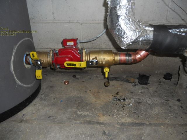

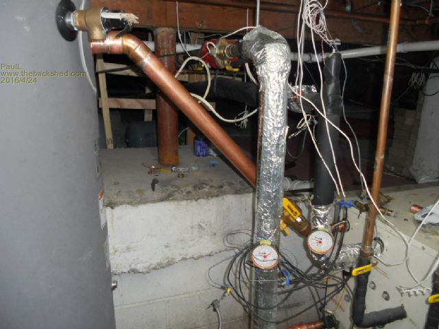

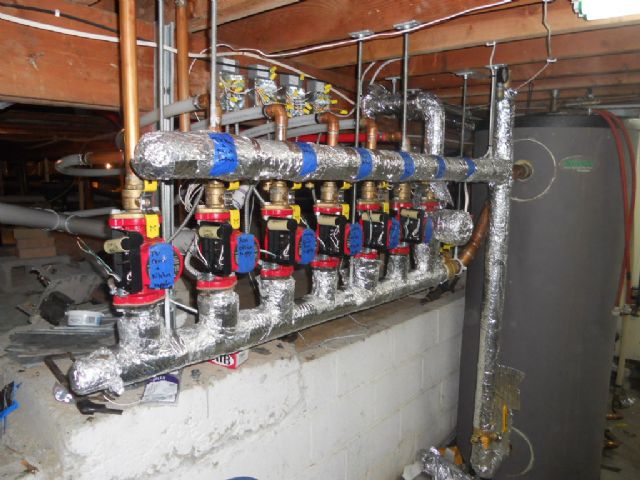

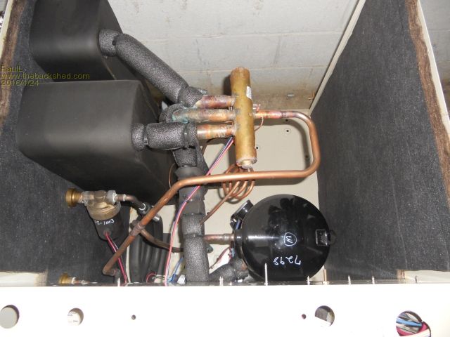

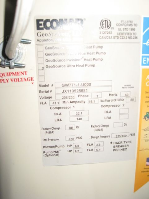

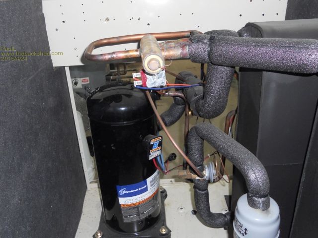

Guenter,
This is the way I did it. Everything is either copper, HDPE or stainless steel.
Except for Brunhilda. She is biological.
Paul
Posted: 08:23pm 23 Apr 2016
Hi Paul, All,
Pardon my Aussie ignorance but what exactly is all of that stuff?
Heat exchanger... OK, I understand that but what do you do with it and where does it take heat from and where does it put it or vice versa as fits the system?
I suspect it is because you are in a cold climate and need to heat your house but that is as far as I can work out..
Looks impressive none the less and it is obviously controllable.

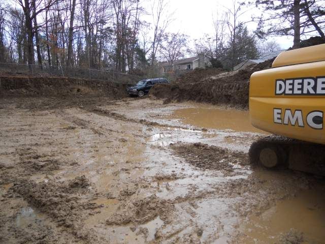

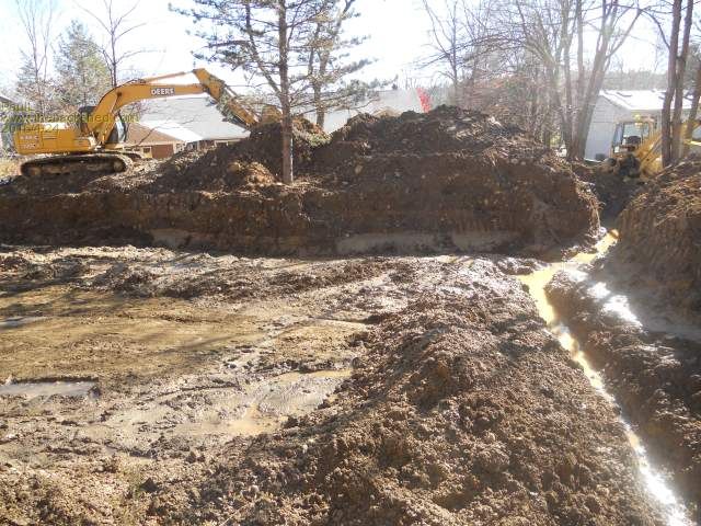

Posted: 08:56pm 23 Apr 2016

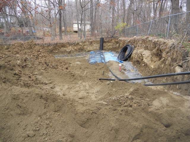

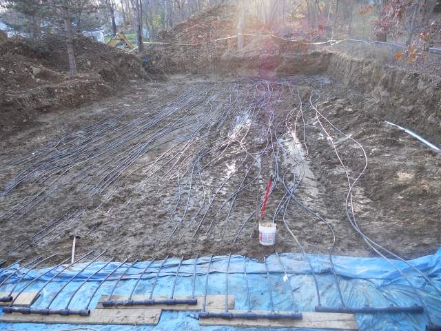

Just in case you guys are wondering what the yard heat exchanger looks like here are some pictures from six years ago. We dug a 100 foot x 60 foot x 7 foot deep hole which promptly began to fill with water from subterranean springs. The John Deere excavator began to sink into the mud so we got it out of there. My full size Chevy Suburban gives some idea of the size of the hole.
Then we cut some drainage ditches with the mini excavator you can see in the distance on the right and waited for the water to drain. The John Deere excavator is on top of the pile of dirt on the left.
Then we unrolled 6000 ft of 3/4 inch HDPE pipe and thermally fused it to a 2 inch manifold.
Finally we ran the 2 inch manifold 200 feet into the basement. The large 2 foot diameter pipe standing vertically in the distance gives permanent access to the air vents at the uphill end of the manifolds.

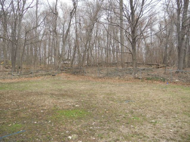

Finally we figured that we'd better fill the hole back up and try to get the grass to grow. You can just see the 2 foot diameter vent access pipe sticking out of the ground in the distance.
That's about all there was to it.

  bigmik said   Hi Paul, All,
Pardon my Aussie ignorance but what exactly is all of that stuff? Mick
Hi Mick,
All that stuff in the pictures is a heat exchanger which pumps heat out of the ground in the winter and into the ground in the summer.
Our hottest days in August (summer here) usually reach about 100°F/38°C and our coldest nights in January (winter) are about -5°F/-21°C. The ground temperature at a depth of 7ft/2m reaches a high of 61°F/16°C in September and a low of 41°F/5°C in March.
In January we pump 25 gal/min or 95 L/min of a water/antifreeze mixture out into the yard heat exchanger at 29°F/-2°C and it returns at about 35°F/+2°C. That's a heat gain of 21.1 kWh/hr (200 pounds/min x 6°F = 1200 Btu/min = 72,100 Btu/hr). But the heat is useless for heating a house because it is stored in water at +2°C.
So we run that water through a plate type heat exchanger which transfers the heat to low pressure Freon at 25°F/-4°C, then we run the Freon through a compressor which produces high pressure Freon at 140°F/60°C which goes to another plate type heat exchanger which transfers the heat to water at about 130°F/54°C which then heats the house.
In August 45°F/7°C water picks up heat from the house and transfers the heat to low pressure Freon which goes through the compressor becoming high pressure Freon which transfers its heat to water which goes to the yard at 110°F/43°C and returns from the yard at 80°F/27°C.
In other words in the winter we pump heat from the 41°F/5°C ground uphill into the 75°F/24°C house, in the summer we pump heat from the 75°F/24°C house into the 61°F/16°C ground.
In 2011 I burned 2414 gallons of #2 fuel oil at a cost of $9294 ($3.85/gal.) and 17080 Kwh of electric power at a cost of $2220 ($0.13/Kwh) for a total of $11,514. In 2013 I burned 215 gallons of #2 fuel oil at a cost of $871 ($4.05/gal.) and 18000 Kwh of electric power at a cost of $2880 ($0.16/Kwh) for a total of $3,751. This thing saved me about $7,800 in 2013.
Now I have to build a better mousetrap to control this gadget.

Here's the label showing the electrical ratings for this gadget. Note that the Freon compressor has a full load current rating of 41.1 A at 230 volts. That's 9,453 watts or 12.67 Hp. Its locked rotor current rating is 148 A. That's a beefy compressor.
This view looks vertically down showing the two insulated stainless steel flat plate heat exchangers on the left and the compressor on the lower right.
This is a horizontal view showing the compressor on the left with the thermal expansion valve to it's immediate right and the heat exchangers on the far right.
