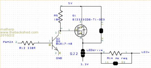

Ok the interrupt works fine and touching the screen varies the duty cycle up and down. Problem is the screen brightness does not vary with the duty cycle, it is all over the place. I'm sure it has something to do with the drive from the BC337. BigMick mentioned in his Backpack170 manual that he had problems and the resistor values were critical, which I don't thing they should be. I am thinking of driving a P Chanel MOSFET with the BC337 but can't find a circuit anywhere on the web.
I can wire it up OK but would like a tried and tested circuit.
Is anyone successfully using PWM and touch to control the backlight on an ILI9341 TFT.
Paul.

Posted: 06:01pm 01 Feb 2016
i recall this same discussion about the backlight driver from some time ago. the correct way to do things is to use a PNP transistor to switch the backlighting in the high side (+5v), and a second transistor that is an NPN to control the base of the PNP. the NPN transistor has its emitter connected to ground. any other approach is likely to produce unpredictable results.
rob :-)

Posted: 10:04pm 01 Feb 2016
I now use this on all my PCBs:
Gives complete flexibility on the PCB allowing fixed 3.3V, fixed 5V or PWM 5V depending on the display, with or without dropper resistor. Just populate the bits you need for any specific application and jumper the requisite shorting links with solder.
Posted: 02:58am 02 Feb 2016
you could probably make R12 a much higher value if you wished, 330r will give a base current of (3.3-0.6)/330 = 8mA when turned on. 3k3 or even 10k should work equally well.
rob :-)

Thanks to everyone, I will try with the Mosfet and see how it goes.

I went with Jim's circuit as it was the easiest and it works fine.
Thanks all.
