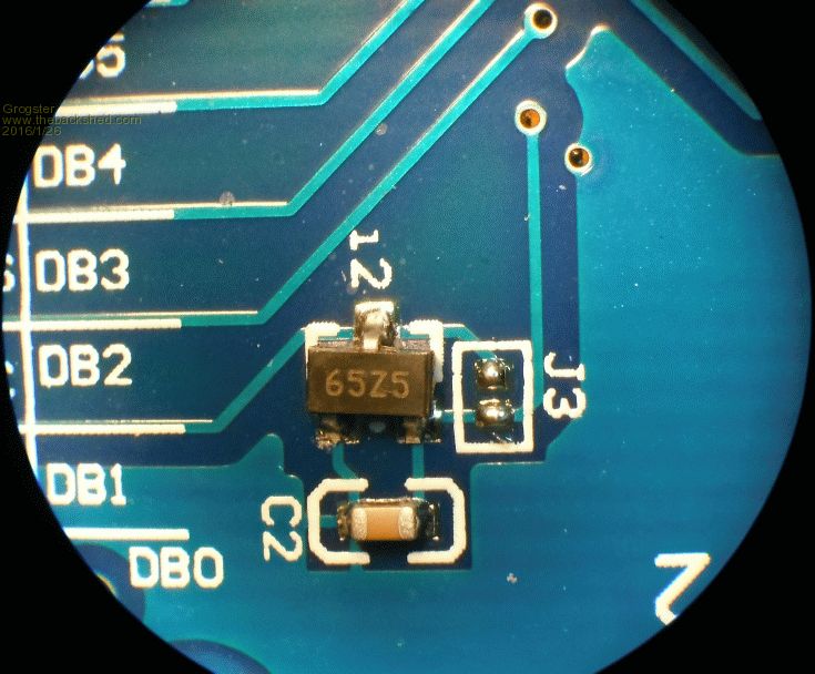

Is J3 on the display PCB open? This is the link that selects between 8-bit and 16-bit operation and must be open.
I've also made J1 which bypasses the regulator as I run 3.3V supply.

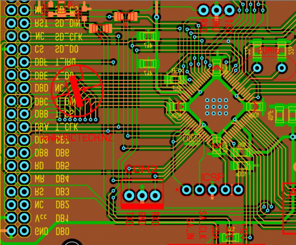

Here is an image of how I have the LCD connected to the 64 pin chip:
I've made the tracks brown on green to make them show up a little better then blue on green. I don't see any obvious mistakes here, but am double-checking this now.
The DB0-DB7 for the 1963 displays as per the MM+ advanced manual, are connected to DB8-DBF on the layout, which is correct 8-15.

  matherp said  I've also made J1 which bypasses the regulator as I run 3.3V supply.
Where is J1?
I only see a J3.
I too am running the display from 3v3, but the backlight from 5v.
EDIT: These are the LCD's I bought, and although the photo looks the same as your ones in the other thread, the ones sent to me are a different PCB:
Note this one uses a different PCB layout from the one in the actual eBay listing.
Do you think it is possible I have been sent the wrong ones?
EDIT: Looks like J3 on THIS LCD is the 3v3 regulator bypass, based on what my microscope is showing me. :
I will try bypassing this by SHORTING the J3 solder blobs. Problem is, if that bypasses the reg, there then is no way to put the display into 8-bit mode, so I might be in the market for more LCD's...

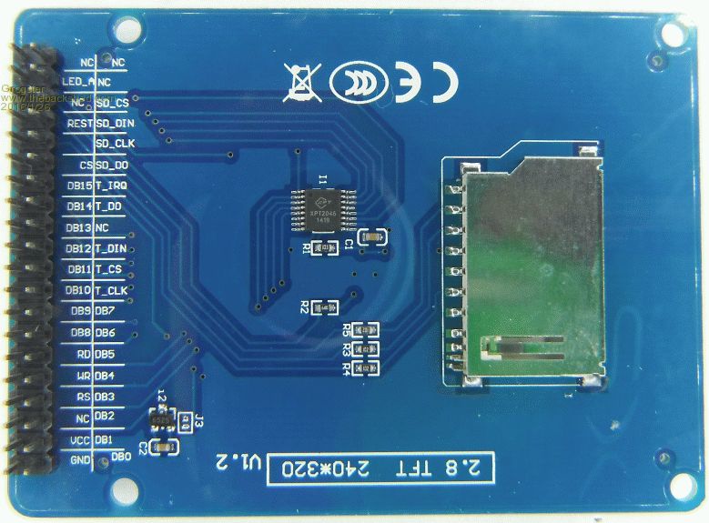

This is certainly a different layout to my display. You could try removing R2. That is in about the same place as J3 on my version. Otherwise you are going to need to lift the display and try and find signal IM0. This needs to be high for 8-bit operation (may be OK to leave it disconnected). If it is pulled low then the controller is set for 16-bit databus

This display is your layout. Note it says that it can be converted to 8-bit operation but doesn't say how.
So it is the 16-bit databus that is definitely the issue. The problem is to find the fix.
Looking at the pics again R" may be the LED resistor (3.9ohm?) if so this won't help.

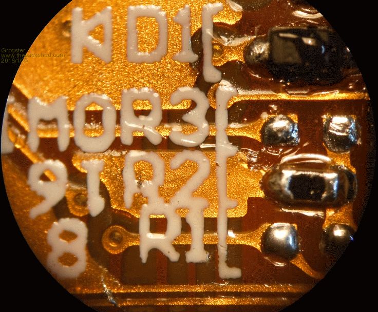

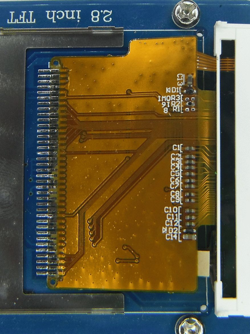

Posted: 12:19am 26 Jan 2016
UPDATE:
Under the shell:
Does that give any insights?
I am thinking that perhaps R2("16"), needs to be removed, and a blob on R1("8")
Would you think this would be a good place to start?
I could TRY to move the black thing on R2, but it is TINY, and I think I would end up having some problems, even under the scope. I could make the attempt though - nothing ventured, nothing gained....
Posts: 12082
Posted: 12:25am 26 Jan 2016
I think you have found it.
Move the resistor that is on R2 to R1.

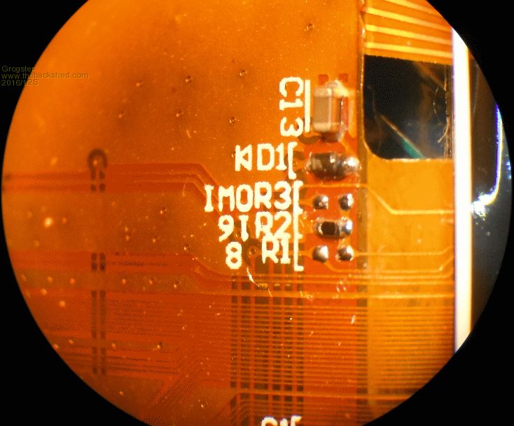

Posted: 12:31am 26 Jan 2016
I will do that and see what happens. Wish me luck.

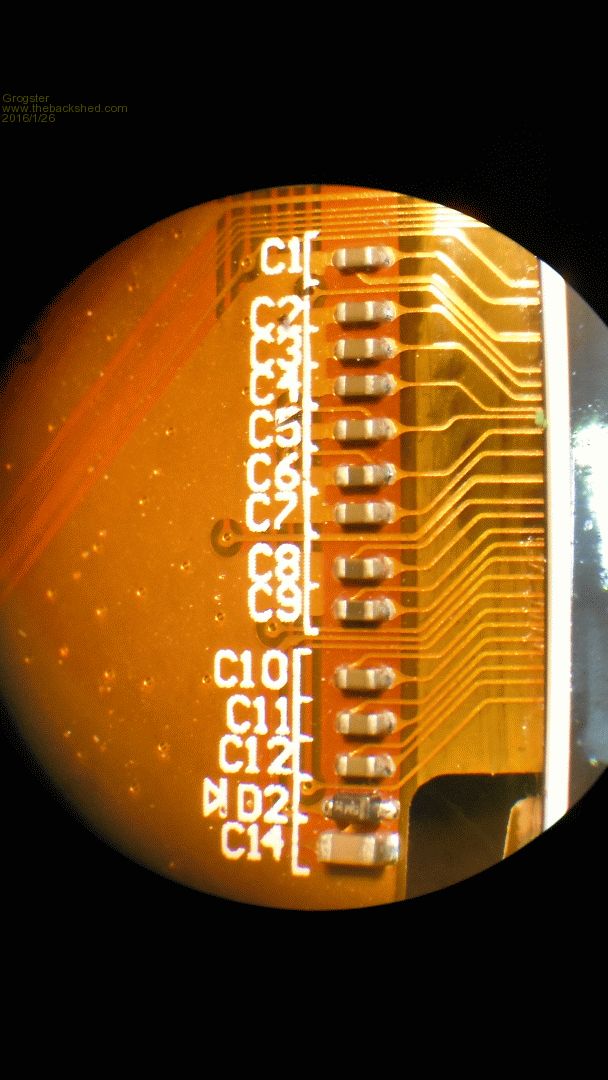

Here is a 30x close-up, but I note that the 'Resistor' is not marked with anything at all to say what the hell it actually is. Normally, resistors are marked. Oh well...
I will try to move it.
Posts: 12082
Posted: 12:34am 26 Jan 2016
I've found if you use the soldering iron in one hand and have a very fine screwdriver in the other, heat the resistor and it will stick to the soldering iron. Move it to the new location and then hold it down with the screwdriver then remove the soldering iron.
There is the same mod on the SSD1289 displays and the above approach worked easily for me
Posted: 12:51am 26 Jan 2016
sharp pointed stainless-steel tweezers. use a soldering iron bit that is wide enough to cover both ends of the resistor at once
0402 resistors generally have no markings.

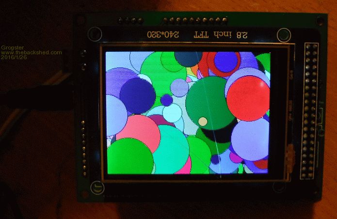

Posted: 12:59am 26 Jan 2016
SUCCESS!!!
That 'Resistor' felt like an 0402 to me, maybe even 0201 - it was frickin' tiny. Only about a quarter the size of the 0805 on the other side of the board. Just a speck, and nothing more.
Managed to move it though - now all I have to do, is do the same move on my other ones to make them 8-bit.
