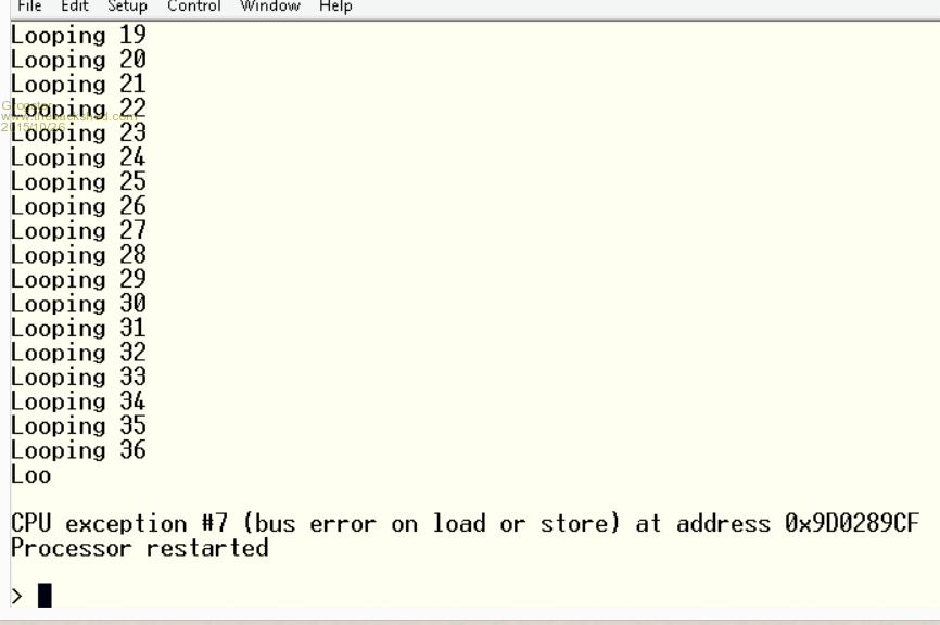

This exact code runs fine on B32, but when reflashed to B37, I also get the same errors with the same code:
It does take at lease two seconds before anything happens - it seems to be running fine for a start.
...odd...

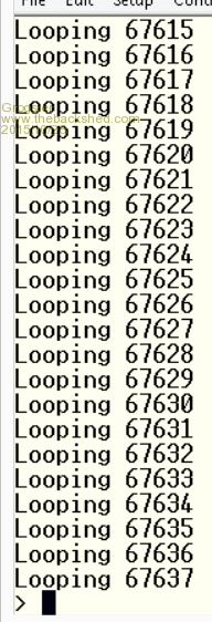

EDIT: Does not happen on B37, if baud-rate slowed to 2400. It runs fine at a slower speed. I will now try faster then 9600...

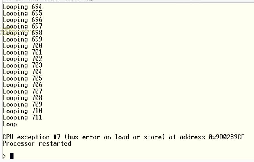

EDIT: Seems to be baud-rate related. This test with 19k2 baud:
COM2 is a software com port, so I guess something is getting upset in there somewhere? That would explain why no problems on com1, as it is a hardware UART.

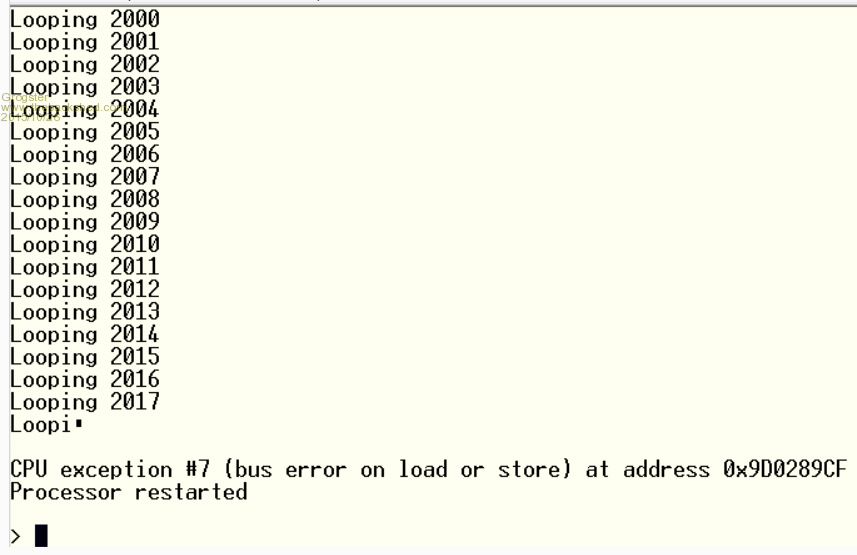

EDIT: 4800 baud:
At 2400 baud, 'Looping' promt goes up over 10,000 no problems. Any speed faster then 2400, and the exception WILL happen, but at shorter and shorter times proportional to the baud-rate.
EDIT: Cannot fault at 2400 baud - up over 65,000 loops and no exceptions.
EDIT: Seems fine up til the non-standard 4700 baud rate. As soon as you try 4750, it falls over with the exception, so something related to around 4800 baud causing the MM to have a hissy fit.
EDIT: Hissy-fit(exception) - 'Looping 11425' @ 4700 baud.Edited by Grogster 2015-10-27
