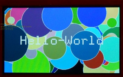

In a thread ages ago someone asked if it was possible to display text without the character background overwriting the existing display - it is now
This builds on the sprite code and uses the same technique of reading the SSD1963 display memory and then writing it back with only the text pixels updated and the background pixels left as-is.
In this case the read of the display is built into the loadable driver code and is triggered by setting the background colour to the value 1. This is chosen as a non-useful colour i.e. a blue so dark it is completely indistinguishable from black.
To use this facility it is necessary to connect the RD pin on the display to the Micromite. The loadable driver will then automatically set this as an output. If the RD pin allocation is omitted in the call to display.open then the driver will work as before and a backgound colour of 1 will be a very dark blue.
At the moment the code will only run on a 44-pin Micromite uM2 using the special loadable SSD1963 driver included in the example code and it needs the pinout set as below:
you must use pins 25,26,27,36,37,38,2,3 for the data pins DB0-DB7
you must use pin 4 for RS and pin 5 for WR
Tie CS Low
connect RD to an unused Micromite output and set the pin number in MM.STARTUP
connect RST to an unused Micromite output and set the pin number in MM.STARTUP
Note that I am using a PWM output to control the display backlight - this is specific to my test system and you probably won't need it.
I will write a version for the MM+ once I have a suitable test system available.
There is one "feature" related to the way Geoff has implemented the space character as a rectangle in the backgound colour rather than as an actual character - unfortunately a space will always overwrite the display in the background colour. The workround is to output multiple strings rather than a single string with spaces.
Also note that the CFunction allocates temporary memory to store the existing display pixels. If you are using a very large scaled font or your program is using most of the Micromite RAM you may see an "out of memory error" when using the overlayed font mode.
My test program is:

* Driver for SSD1963 Display written as CFunctions
* (c) Peter Mather 2015 with acknowledgements to Peter Carnegie & Geoff Graham
* This CFunction MUST be compiled with Optimization Level 1, -O1
* -O2,-O3,-Os will compile successfully, but generate exceptions at runtime.
* When Generating the CFunction, use MERGE CFunction mode, and name the CFunction
* SSD1963_V44
* Entry point is function long long main(long long *MyAddress,
* long long *RST,
* long long *orientation
* long long *size)
* V1.0 2015-07-21 Peter Mather
* 1.01 Change orientation codes to 1:landscape, 2:portrait, 3:rlandscape, 4:rportrait
* 1.02 Use fixed PortC pinout for maximum performance
* 1.03 Stripped routines for use as loadable LIBRARY
* 1.04 Conditional compilation for 44 and 64-pin parts
#include <stdarg.h>
#define Version 103 //Version 1.03
#define MX470 //Comment out for compilation for 44-pin part
#include "../cfunctions.h"
#define bclrport *(volatile unsigned int *)(0xbf886134) //latch registers
#define bsetport *(volatile unsigned int *)(0xbf886138) //latch registers
#define cport *(volatile unsigned int *)(0xbf886230) //latch registers
#define cread *(volatile unsigned int *)(0xbf886220) //latch registers
#define ctrisinv *(volatile unsigned int *)(0xbf88621C) //latch registers
#define cclrport *(volatile unsigned int *)(0xbf886234) //latch registers
#define csetport *(volatile unsigned int *)(0xbf886238) //latch registers
#define eport *(volatile unsigned int *)(0xbf886430) //latch registers
#define eread *(volatile unsigned int *)(0xbf886420) //latch registers
#define etrisinv *(volatile unsigned int *)(0xbf88641C) //latch registers
#define eclrport *(volatile unsigned int *)(0xbf886434) //latch registers
#define esetport *(volatile unsigned int *)(0xbf886438) //latch registers
#define DEVID (*(volatile unsigned int *)0xBF80F220)
//Offsets into the persistent RAM of variables
#ifdef MX470
#define RS_Pin_No 27
#define WR_Pin_No 24
#define RS_Pin 0x1000
#define WR_Pin 0x0800
#define clrport bclrport
#define setport bsetport
#define port eport
#define read eread
#define trisinv etrisinv
#define RSLo {clrport=RS_Pin;}
#define RSHi {setport=RS_Pin;}
#define WRLo {clrport=WR_Pin;}
#define WRHi {setport=WR_Pin;}
#else
#define RS_Pin_No 4
#define WR_Pin_No 5
#define WR_Pin 0x200
#define clrport cclrport
#define setport csetport
#define port cport
#define read cread
#define trisinv ctrisinv
#define RSLo clrport=RS_Pin
#define RSHi setport=RS_Pin
#define WRLo clrport=WR_Pin
#define WRHi setport=WR_Pin
#endif
#define Both WR_Pin | RS_Pin
#define RDLo (*(volatile unsigned int *)RDclrport)=RDpin
#define RDHi (*(volatile unsigned int *)RDsetport)=RDpin
#define LANDSCAPE 1
#define PORTRAIT 2
#define RLANDSCAPE 3
#define RPORTRAIT 4
* Write Data to a register on the Chip
void write_command_data(unsigned int command, int data, ...){
int i;
#ifdef MX470
RSLo;
#endif
va_list ap;
va_start(ap, data);
port=(command & 0x00FF) | WR_Pin; WRLo; WRHi; // RS low
#ifdef MX470
RSHi;
#endif
for(i = 0; i < data; i++) {
port= (char)va_arg(ap, int) | Both; WRLo; WRHi; //RS high
va_end(ap);
* defines start/end coordinates for memory access from host to SSD1963
* also maps the start and end points to suit the orientation
* This function is a modified version of the function inside the MMBasic Interpreter
* for MM+ on 'MX470 chips
void defineregion(long x, long y, long width,long height){ //SSD1963
long x1=x,x2=x+width-1,y1=y,y2=y+height-1;
unsigned long xstart,xend,ystart,yend,Vertical,Horizontal;
#ifdef MX470
RSLo;
#endif
if(HRes>VRes){
Vertical=VRes;
Horizontal=HRes;
else {
Vertical=HRes;
Horizontal=VRes;
if(Option->DISPLAY_ORIENTATION!=LANDSCAPE)goto isP;
xstart = x1;
xend = x2;
ystart = y1;
yend = y2;
if(Option->LCD_CD>6){ //reverse for 7" displays
xstart = (Horizontal - 1) - x2;
xend = (Horizontal - 1) - x1;
goto setreg;
isP:
if(Option->DISPLAY_ORIENTATION!=PORTRAIT)goto isRL;
xstart = y1;
xend = y2;
ystart = (Vertical - 1) - x2;
yend = (Vertical - 1) - x1;
goto setreg;
isRL:
if(Option->DISPLAY_ORIENTATION!=RLANDSCAPE)goto isRP;
ystart = (Vertical - 1) - y2;
yend = (Vertical - 1) - y1;
if(Option->LCD_CD>6){//reverse for 7" displays
xstart = x1;
xend = x2;
goto setreg;
isRP:
xstart = (Horizontal - 1) - y2;
xend = (Horizontal - 1) - y1;
ystart = x1;
yend = x2;
setreg:
port=0x22A ;WRLo; WRHi; // RS low
#ifdef MX470
RSHi;
#endif
port=(xstart>>8 ) | Both; WRLo; WRHi; // RS HIGH
port=(xstart) | Both; WRLo; WRHi; // RS HIGH
port=(xend>>8 ) | Both; WRLo; WRHi; // RS HIGH
port=(xend) | Both; WRLo; WRHi; // RS HIGH
#ifdef MX470
RSLo;
#endif
port=0x22B ; WRLo; WRHi; // RS low
#ifdef MX470
RSHi;
#endif
port=(ystart>>8 ) | Both; WRLo; WRHi; // RS HIGH
port=(ystart) | Both; WRLo; WRHi; // RS HIGH
port=(yend>>8 ) | Both; WRLo; WRHi; // RS HIGH
port=(yend) | Both; WRLo; WRHi; // RS HIGH RSHi;
* Display the bitmap of a char on the TFT panel
* This function is NEVER called by MMBasic programs
* This is optimised for the
* x, y - the top left of the char
* width, height - size of the char's bitmap
* scale - how much to scale the bitmap
* fg, bg - foreground and background colour
* bitmap - pointer to the butmap
void DrawBitmap_SSD1963(int x1, int y1, int width, int height, int scale, int fc, int bc, unsigned char *bitmap ){
long i, j, k, m, n, RDpin, RDsetport, RDclrport;
unsigned int fhb,fmb, flb, bhb, bmb, blb, xtest, ytest;
char *p;
xtest=HRes;
ytest=VRes;
if(bc==1 && Option->LCD_CS!=0){ //special case of overlay text
RDpin=1<<GetPinBit(Option->LCD_CS);
RDsetport=(unsigned int)GetPortAddr(Option->LCD_CS,LATSET);
RDclrport=(unsigned int)GetPortAddr(Option->LCD_CS,LATCLR);
i=0;
j=width*height*scale*scale*3;
p=GetMemory(j); //allocate some temporary memory
defineregion(x1,y1,width*scale,height*scale);
#ifdef MX470
RSLo;
#endif
port=0x22E ; WRLo; WRHi; // RS low
#ifdef MX470
RSHi;
#endif
trisinv=0xFF; //set pins to read
do { //read in the screen area to be overlayed
RDLo;
n=DEVID;n=DEVID;
RDHi;
p[i++]=(read & 0xFF);
RDLo;
n=DEVID;n=DEVID;
RDHi;
RDLo;
n=DEVID;n=DEVID;
RDHi;
} while(i<j);
trisinv=0xFF; //set pins to write
// convert the colours to 888 format
fhb = (fc >> 16) | Both;
fmb = (fc >> 8) | Both;
flb = fc | Both;
bhb = (bc >> 16) | Both;
bmb = (bc >> 8) | Both;
blb = bc | Both;
n=0;
#ifdef MX470
RSLo;
#endif
port=0x22C ; WRLo; WRHi; // RS low
#ifdef MX470
RSHi;
#endif
for(i = 0; i < height; i++) { // step thru the font scan line by line
for(j = 0; j < scale; j++) { // repeat lines to scale the font
for(k = 0; k < width; k++) { // step through each bit in a scan line
for(m = 0; m < scale; m++) { // repeat pixels to scale in the x axis
if(x1 + k * scale + m >= 0 && x1 + k * scale + m < xtest && y1 + i * scale + j >= 0 && y1 + i * scale + j < ytest) { // if the coordinates are valid
if((bitmap[((i * width) + k)/8] >> (((height * width) - ((i * width) + k) - 1) %8)) & 1) {
port=fhb; WRLo; WRHi;
port=fmb; WRLo; WRHi;
port=flb; WRLo; WRHi;
n+=3;
} else {
port=p[n++] | Both; WRLo; WRHi;
} else {
port=bhb; WRLo; WRHi;
port=bmb; WRLo; WRHi;
port=blb; WRLo; WRHi;
if(bc==1 && Option->LCD_CS!=0) FreeMemory(p);

DrawBitmapVectorOffset=*MyAddress + ((unsigned int)&DrawBitmap_SSD1963 - (unsigned int)&main);
//Save DisplayMetrics
if(Option->LCD_CD<5){
HorizontalRes=480;
VerticalRes=272;
} else {
HorizontalRes=800;
VerticalRes=480;
//Reset the SSD1963
PinSetBit(Option->LCD_Reset,LATSET);
uSec(10000);
PinSetBit(Option->LCD_Reset,LATCLR);
uSec(10000);
uSec(10000);
if(Option->LCD_CD<5) {
write_command_data(0xE2,3,0x23,0x02,0x54);
} else {
if(Option->LCD_CD<6){
write_command_data(0xE2,3,0x1E,0x02,0x54);
} else {
write_command_data(0xE2,3,0x23,0x02,0x04);
write_command_data(0xE0,1,0x01); uSec( 10000); // PLL enable
write_command_data(0xE0,1,0x03); uSec( 10000);
write_command_data(0x01,0); uSec( 100000); // software reset
write_command_data(0xE6,3,0x01,0x1F,0xFF);
write_command_data(0xB0,7,0x20,0x00,0x01,0xDF,0x01,0x0F,0x00); //LCD SPECIFICATION
write_command_data(0xB4,8,0x02,0x13,0x00,0x08,0x2B,0x00,0x02,0x00);
write_command_data(0xB6,7,0x01,0x20,0x00,0x04,0x0C,0x00,0x02);
} else {
if (Option->LCD_CD<6){
write_command_data(0xE6,3,0x03,0xFF,0xFF);
write_command_data(0xB0,7,0x24,0x00,0x03,0x1F,0x01,0xDF,0x00); //LCD SPECIFICATION
} else {
write_command_data(0xE6,3,0x04,0x93,0xE0);
write_command_data(0xB0,7,0x00,0x00,0x03,0x1F,0x01,0xDF,0x00); //LCD SPECIFICATION
write_command_data(0xB4,8,0x03,0xA0,0x00,0x2E,0x30,0x00,0x0F,0x00);
write_command_data(0xB6,7,0x02,0x0D,0x00,0x10,0x10,0x00,0x08);
write_command_data(0xBA,1,0x0F);
write_command_data(0xB8,2,0x07,0x01);
write_command_data(0x36,1,0x00); //rotation
write_command_data(0xF0,1,0x00); //PIXEL data interface - 8-bit
write_command_data(0x3A,1,0b01110000); //PIXEL data interface 24-bit
write_command_data(0x26,1,0x01); uSec( 10000); //gamma curve
write_command_data(0x29,0); //display on
write_command_data(0xBE,6,0x06,0xF0,0x01,0xF0,0x00,0x00); //set PWM for B/L
write_command_data(0xd0,1,0x0D);
//Set Hres and VRes
if(Option->DISPLAY_ORIENTATION==PORTRAIT){
if (Option->LCD_CD<6) t=0xA0;
else t=0xE0;
if(Option->DISPLAY_ORIENTATION==RPORTRAIT){
if (Option->LCD_CD<6) t=0x60;
else t=0x20;
if(Option->DISPLAY_ORIENTATION==LANDSCAPE){
if (Option->LCD_CD<6) t=0x00;
else t=0x40;
if(Option->DISPLAY_ORIENTATION==RLANDSCAPE){
if (Option->LCD_CD<6) t=0xC0;
else t=0x80;
write_command_data(0x36,1,t);
if(Option->DISPLAY_ORIENTATION&1){
HRes=HorizontalRes;
VRes=VerticalRes;
} else {
VRes=HorizontalRes;
HRes=VerticalRes;
//Set the DrawRectangle vector to point to our function
DrawRectangleVector=DrawRectangleVectorOffset;
//Set the DrawBitmap vector to point to our function
DrawBitmapVector=DrawBitmapVectorOffset;
//CLS
DrawRectangle(0,0,HRes-1,VRes-1,0x000000);
return 0;
