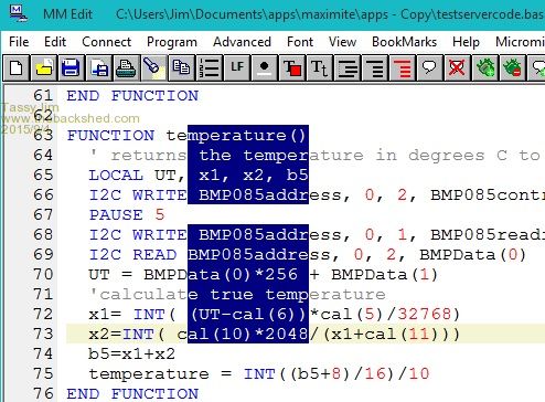

I agree that Notepad++ is great.
I use metapad (which I don't think has block select).
MMEdit does!
Same as Notepad++, Alt+Mouse or check the keyboard shortcuts in the help.

Posts: 3369
Posted: 12:33am 04 Sep 2015
MMEdit is brilliant - I never knew that it could do that.
  TassyJim said  Real programmers don't use a mouse.
A sure sign of a programmer brought up on text based languages (aka, BASIC).Edited by Geoffg 2015-09-05
Posts: 6631
Posted: 11:28am 04 Sep 2015
  Geoffg said   MMEdit is brilliant - I never knew that it could do that.
I had forgotten all about the block select feature.
It is a method I used to use a lot many years ago but not for a long time now.
I expect that any editor that uses Scintilla as it's base will do the same block select method.
99% if the keyboard shortcuts are also built into Scintilla so I can't take any credit for them either.
