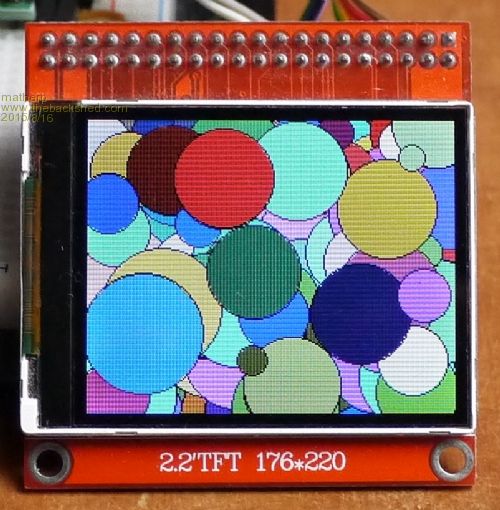

This post has code for the 2.2" 176x220 displays based on the S6D0164 graphics chip. These displays have the advantage of being very fast to drive with an 8-bit parallel bus and very bright.
Note that pins DB8-DB15 are used on this display for the 8-bit databus connections.
The code includes optimisations that increase performance on the uM+ if the pins designated LCD_D0-LCD_D7 are used for DB8-DB15 as in the example code below
The code is also optimised if pins 25,26,27,36,37,38,2,3 are used for DB8-DB15 on a 44-pin MX170. In this case pins 4 and 5 must be left unconnected.
Otherwise performance is still good with a completely free selection of pins on any of the uM2(+) variants.

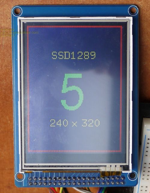

Next driver is for the SSD1289 typically seen in 3.2" 240 x 320 versions
This has a 16-bit parallel interface + 3 control lines (RS, WR, and RESET) so although it is theoretically possible to use on a 28-pin uM2 it is more useful on the 44-pin uM2 or UM+.
Note that the basic mechanisms of the routines to set up the display are identical to those for the S6D0164 and Peter Carnegie's SSD1963 driver.
These displays also support touch input. To use the inbuilt touch mechanism with the loadable display is easy.
Run the attached program but comment out the line:
Retrn%=Display.Close()
Once the GUI TEST DISPLAY is running (lots of circles) press return on the console to stop the program. This will leave the display driver loaded and operational.
Then enter "OPTION TOUCH cspin,irqpin" substituting in the the correct pin numbers.
Finally enter "GUI CALIBRATE" to calibrate the touch system.
Now you can reset the processor and the touch characteristics for your display will have been stored.
You can now run your own program using the loadable driver and full touch input support as per the in-built drivers

Last one for the moment.
This driver is for the SSD1963 but drives the display in RGB666 mode rather than RGB888 as used in the uM+ firmware and Peter Carnegie's SSD1963 driver. In order to do this it uses a 9-bit data bus (DB0-DB8) rather than 8 bits.
The advantage is that drawing takes about 33% less time than the 8-bit driver.
The disadvantage is the loss of colour resolution and one extra pin.
This driver is especially useful on the 44-pin uM2. In this case if pins 23,24,25,36,37,38,2,3,4 are used (in that order) for DB0-DB8 then the driver will optimise writing by using PortC on the chip. This will make a huge speed improvement allowing performance on the uM2 (MX170) to approach that of the much faster uM+ (MX470) chip by only using 2 write commands per pixel rather than 3. In this case pin 5 must be left unconnected.
The driver can be used on the uM+ but there is no advantage over the in-built driver.
OPTION EXPLICIT
OPTION DEFAULT None
PRINT "SSD1963 9-bit CFunction Driver Example"
'4.3" inch display
CONST Size!=4.3
'Initialise the Display Driver
'Function Display.Open(D0%,D1%,D2%,D3%,D4%,D5%,D6%,D7%,D8%,RS%,WR%,RST%,Orientation%,Size!)
' NB Tie CS Low and tie RD high
' Orientation% is 1 for landscape, 2 for Portrait orientation, 3 for reverse landscape, 4 for reverse portrait
dim Orientation%=1
dim Retrn%=Display.Open(25,26,27,36,37,38,2,3,4,21,22,19,Orientation%,Size!)
' Display the driver version number
print "Driver version is ",Display.Ver()
'Use Font 2 and scale x4
Font 2,4
'Yellow FG, Dark Blue BG
Colour &HFFFF00,&H000066
'Clearscreen
CLS
'Draw a Red Frame
Box 0,0,MM.HRes-4,MM.VRes-4,4,&HFF0000,-1
Text MM.HRES\2-120,(MM.VRes/2)-100,"SSD1963"
Text MM.HRES\2-130,(MM.VRes/2)+70,STR$(MM.HRes)+" "+STR$(MM.VRes),,1,1
Text MM.Hres\2 - 20,(MM.VRes/2)+70,"x"
DIM I%
'Countdown
FOR I%=9 TO 0 STEP -1
Text (MM.Hres/2)-40, (MM.VRes/2)-35,STR$(I%),,1,2,&H00FF00,&H000066
PAUSE 900
NEXT I%
'Change Orientation to Portrait to show that calling
'Display.Open again in a program is legal
Orientation%=2
Retrn%=Display.Open(25, 26, 27, 36, 37, 38, 2, 3, 4, 21, 22, 19, Orientation%, Size!)
GUI Test Display
'Close the driver
END
