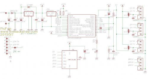

Below the diagram of the module, as the power supply are used 4 x 1.2V NiMH batteries. As R1 I tested from 0 to 10k, 10k and also a capacitor with 0.1uF - 1uF to 0V did not improve. The best results are with 10k without C to 0V. Konsole RX/TX are open or connected to COM1 from a 2. Micromite.
Everything worked correct for months with the PIC32MX150, but since conversion to "170" occur these problem.
Thanks to all!

Can you please email the Circuit Diagram as not too clear on here - Thanks!
Posts: 2991
Posted: 05:48am 08 May 2015
@PicFan
Thanks for emailing the circuit.
Two things:
1> Have you powered the circuit from a mains power supply? If so, does it still behave the same (i.e. erase the program whenever you connect/remove power?
2> Try swapping the 10uF cap between pins 27 & 28 with a 100nF (0.1uF) ceramic.
Nothing else seems to potentially cause the issue you are witnessing so the only other thing I would try is to remove D2. I fully understand why you have it in place but just see if when removed it 'resolves' things.
I assume you have nothing connected to the console pins when the 'erase' occurs. If the MM is in a socket then can I also recommend 'isolating' pins 11&12 by removing the PIC, then bending those two pins outwards, and then reinserting the PIC back into the socket so that those two pins are not actually in the socket (hope that makes sense!). The purpose is to isolate any PCB track issues (assuming a PCB is in use!).
One last thought - if the circuit is ultra lower power, then try adding an LED across 3v3 just to pull some current (about 20mA). With this in place - does it change things. Obviously you don't want to leave this in place for a battery powered circuit - just use it to try isolate the issue)
