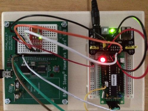

This post is a status of the work I've been doing related to the FPU64 coprocessor from MicroMega. I've been trying to understand how to interact with the chip as well as writing double precision functions that reside within the chip.
The following is a picture of the setup that I'm using. The BASIC STAMP 2 micro-controller is used to communicate with the FPU64. This is done via a USB Homework Board which is on the left in the picture. The small breadboard on the BS2 board contains a USB-to-TTL board from WhiteWizzard. It is used to communicate directly with the FPU64 chip. On the right side of the picture is a power supply and the FPU64. The power supply provides 5 volts for the BS2 and 3.3 volts for the FPU64.
The BS2 board contains a USB interface which connects to a Windows 7 PC. Communication between the BS2 and FPU64 uses the SPI interface.

Reset:
DEBUG CR, "Julian and Calendar Date Example"
DEBUG CR, "--------------------------------", CR
DEBUG CR
' Reset the uM-FPU and print version
GOSUB Fpu_Reset
IF (status <> SyncChar) THEN
DEBUG "uM-FPU not detected"
END
ELSE
' display the uM-FPU version number
GOSUB Print_Version
DEBUG CR
ENDIF
' main routine
Main:
' load calendar date
SHIFTOUT FpuOut, FpuClk, MSBFIRST, [SELECTA, month, ATOF, "4.0", 0, FSET0]
SHIFTOUT FpuOut, FpuClk, MSBFIRST, [SELECTA, day, ATOF, "16.3754895", 0, FSET0]
SHIFTOUT FpuOut, FpuClk, MSBFIRST, [SELECTA, year, ATOF, "2015.0", 0 , FSET0]
' compute julian date
SHIFTOUT FpuOut, FpuClk, MSBFIRST, [FCALL, julian, SELECTA, jdate]
DEBUG CR, "Julian Date "
GOSUB Print_Float
' compute calendar date
SHIFTOUT FpuOut, FpuClk, MSBFIRST, [FCALL, gdate, SELECTA, month]
DEBUG CR, CR, "Calendar Date ", CR
GOSUB Print_Float
SHIFTOUT FpuOut, FpuClk, MSBFIRST, [FCALL, gdate, SELECTA, day]
DEBUG CR
GOSUB Print_Float
SHIFTOUT FpuOut, FpuClk, MSBFIRST, [FCALL, gdate, SELECTA, year]
DEBUG CR
GOSUB Print_Float
DEBUG CR, CR, "done", CR
END
' uM-FPU64 SPI support routines
Fpu_Reset:
[$FF, $FF, $FF, $FF, $FF, $FF, $FF, $FF, $FF, $FF]
PAUSE 10
' check for synchronization
SHIFTOUT FpuOut, FpuClk, MSBFIRST, [SYNC]
GOTO Fpu_Status2
Fpu_Wait:
' (required for 2-wire interface)
INPUT FpuIn
Fpu_Wait2:
' wait until uM-FPU is ready
IF (FpuIn = 1) THEN GOTO Fpu_Wait2
RETURN
Fpu_ReadStatus:
' read status byte
GOSUB Fpu_Wait
SHIFTOUT FpuOut, FpuClk, MSBFIRST, [READSTATUS]
Fpu_Status2:
SHIFTIN FpuIn, FpuClk, MSBPRE, [status]
RETURN
Print_Version:
' print the uM-FPU version string
SHIFTOUT FpuOut, FpuClk, MSBFIRST, [VERSION]
GOTO Print_FpuString
Print_Float:
' set format to zero (free format)
' (fall through to Print_FloatFormat)
format = 0
Print_FloatFormat:
' convert floating point to formatted ASCII
opcode = FTOA
GOTO Print_Format
Print_Long:
format = 0
Print_LongFormat:
' convert long integer to formatted ASCII
' (fall through to Print_Format)
opcode = LTOA
Print_Format:
' send conversion command
SHIFTOUT FpuOut, FpuClk, MSBFIRST, [opcode, format]
Print_FpuString:
SHIFTOUT FpuOut, FpuClk, MSBFIRST, [SETREAD]
GOSUB Fpu_Wait
SHIFTOUT FpuOut, FpuClk, MSBFIRST, [READSTR]
DO
' display zero terminated string
SHIFTIN FpuIn, FpuClk, MSBPRE, [dataByte]
IF (dataByte = 0) THEN EXIT
DEBUG dataByte
LOOP
RETURN
The following is the output displayed by the BS2.
uM-FPU64 r411
Julian Date 2457128.8754895
Calendar Date
4.0
16.3754894998856
2015.0
done
My next effort is to determine how to interact with the FPU64 using the SPI commands of the Micromite. Naturally, any help is appreciated.
