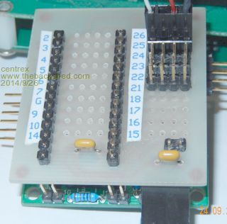

I personally would prefer small plug in modules for connecting to the MicroMite and to this end I made myself a board the same size as BigMicks MuP that allows me to connect what I want.
This board plugs directly into the MuP and gets as well as all the i/o pins the 5volt supply from the I2C section of the MuP.
I have not fitted all the pins to the i/o as yet but the MuP is running the RTC, 4X20LCD, BMP085 and a DS18B20.
Hopefully in the very near future a FRAM memory module.

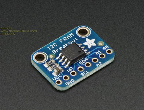

Adafruit has a FRAM breakout board I2C 32Kbytes all for $10 us, all we need is someone to write the software to suit the MicroMite, not my field of expertise.
Probably many others on the market, but it does make it easy to get started.
Heres hoping.
Cliff

@ centrex - can you please post a link for that module you put up the photo for?

Posted: 04:11pm 27 Sep 2014
Hi Grogster
Google ADAFRUIT FRAM it will be in the first couple of items.
https://learn.adafruit.com/adafruit-i2c-fram-breakout/overvi ew
To me this is the simplest way to go.
Cliff
Cliff
Posted: 08:23pm 27 Sep 2014
I'm inclined to agree, for the purposes of bench-testing, anyway.
Here is a clickable link to the FRAM Module
I think I will get a couple, and run some tests. The sequential writing tests are the ones I am interested in, but the fact that you can grab any address and start writing from there without ever caring about page boundaries is heaven for me.
