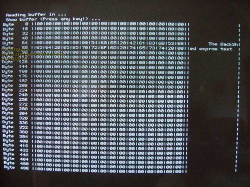

the code above is for MAXImite, sorry. Maybe some print-functions are different on µmite? I have no access to µmites.
On my Duinomite the output from eeDump looks like this:
Perhaps this will work on your µmite also (needs no format$-function)?

I think you'll confirm that for Byte Write, as in my code, no problems should be expected? Page Write has some advantage but it maks things more complicated. The Microchip datasheet says a 24C32 has a page size of 8 bytes.

  twofingers said   @Grogster
Confirmed - and exactly right.
Byte writing is not a problem, page-writing IS.
...IF you page write, which is what I was doing in my application, then you can easily get yourself into a hell of a mix, which is what happened to me, until the guys over at the PICAXE forums explained pages to me, so I just did not want anyone here having that same issue.
The reason your screen-dump works fine, is cos you have the pause 5 after every byte write to the I2C bus, which gives the EEPROM time to commit it, so with that delay in place within the loop, you should have no problems at all byte-by-byte writing across the page boundry.
Try doing that as a page write WITHOUT the 5ms delay.

For i = 1 To 20
Z(i)=1/i
Print "Save: ",i, Z(i)
eeSaveF (i*4, z(i))
z(i)=0
Print "Set to zero:",i, Z(i)
eeLoadF (i*4, z(i))
Print "Restored: ",i, Z(i)
Print
wait "<Press any key>"
Next i
eeDump
End
'********** END EXAMPLE CODE ************
Sub eeSaveF (address, v)
' Saves a floatingp. var to AT24C32
local i
For i = 0 To 3
eewriteN address+i, Peek(VAR v,i)
Next i
Sub eeLoadF (address, v)
' Load a floatingp. var from AT24C32
local i
For i = 0 To 3
Poke VAR v,i, eeReadN(address+i)
Next i
Sub eeWriteN (address, Number)
' Write a number to AT24C32
local MSB, LSB
I2CADDR=&H57 ' 24C32-DS3231
I2C open 100,100 'ENABLE I2C
msb=Int(address/256) 'MSB
lsb=address Mod 256 'LSB
I2C write I2CADDR, 0, 3, msb, lsb, Number
Pause 5
If MM.I2C <>0 Then Print "Error! 1=NAK 2=TIMEOUT"; MM.I2C:End:EndIf
I2C close
If debug Then Print Number;" written into EEPROM."
Function eeReadN (address)
' Read a number from AT24C32
local MSB, LSB
I2C write I2CADDR, 0,2,msb,lsb
I2C read I2CADDR, 0,1,eeReadN
If MM.I2C <>0 Then Print "ERROR! 1=NAK 2=TIMEOUT"; MM.I2C:eeReadN=-1:End:EndIf
I2C close
End Function
' EEPROM komplett LESEN
' Shows content from AT24C32
Sub eedump
Local i, j, y, L, RTCBUFF(4096)
For I = 0 To 4095
RTCBUFF(I)=&H0
Next I
Print " Reading buffer in ..."
For J=&H0 To &HF
For I=&h0 To &hFF
L=(j*256+I)
I2C write I2CADDR, 0,2,J,I
I2C read I2CADDR, 0,1,RTCBUFF(L)
If MM.I2C <>0 Then Print "ERROR! 1=NAK 2=TIMEOUT"; MM.I2C,j,i:End:EndIf
Next I
Next J
I2C close
Print " Show buffer (Press any key!) ..."
For I=0 To 4095 Step 16
Print "Byte ";Format$(I,"%4g");" ||";
For y = 0 To 15
Print Right$("0"+Hex$(RTCBUFF(I+y)),2);"|";
Next y
Print "|";
For y = 0 To 15
If RTCBUFF(I+y) >=32 And RTCBUFF(I+y)<=126 Then ' show ascii only
C$=Chr$(RTCBUFF(I+y))
Else
C$=" "
Print C$;
Next y
Print "|"
wait
Next I
