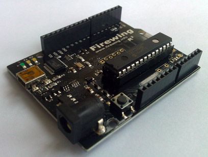

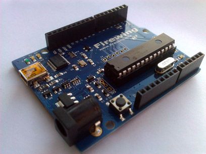

That would be much easier in interfacing it using a Firewing board and language (VB,NET) and results will be on par with Arduino if you use an 8bit microcontroller, or much better if a 16bit/32bit one is used.
Firewing R2 8bit board:
Firewing R2 16bit/32bit board:
Firewing IDE download.
ColorTFT Tutorial.
ColorTFT Examples.Edited by vasi 2014-08-07
