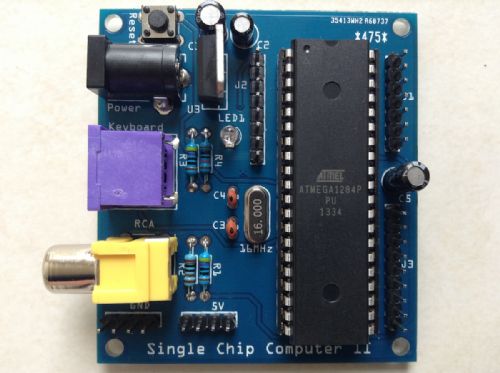

Interesting Basic Computer built around and 8-bit device and completely easy to built DIP package.
Wonder if this could be done with a PIC18F and Great Cow Basic.
More Info Here

If PIC18F has to be involved, it must be a 64MHz capable device 'cause it will match the ATmega1284P speed at 16MHz. P18F46K22 is a 40 pin device with 64Kb FLASH (do we have one with 128Kb?) and 4KB RAM (that ATmega has 16Kb RAM - a monster). Good for Dk-Basic.
The SPI, I2C and Analog pins on ATmega are available on those free ports...
I think it is possible if the TV-out thing can be implemented.
Anyway, I guess Microchip complicate too much the peripheral thing... too many features are battling for the available pins...

Oops. in the actual implementation, around 8Kb of RAM are used for Video frame buffer. A gameduino 2 (or even one from Olimex) is a requirement. And with Dk-Basic (bytecode compilation) you can make a better 8bit computer. Still, too less RAM on PIC18F!
From the comments, there is a tip regarding Video:
[quote]Just a tip from someone who built this before: try using SPI2X for serializing the video output, or alternately use a 74165 PISO. You'll get much better video resolution, definitely worth it. [/quote]Edited by vasi 2014-07-15

PIC18F67K22 has 128k and 3.8k RAM but its a 64 pin part so you lose the DIP package.
I didn't see any reference for the Gameduino requirement.

It becomes a requirement if you want to do your own using a PIC18F as you don't have a 8Kb of RAM for the video frame buffer. On other words, you give up on generating video signal using the microcontroller and you have more features for the BASIC interpreter. I thought my comments where clear enough... I have to work more on my English. It is everything there, in your link...
